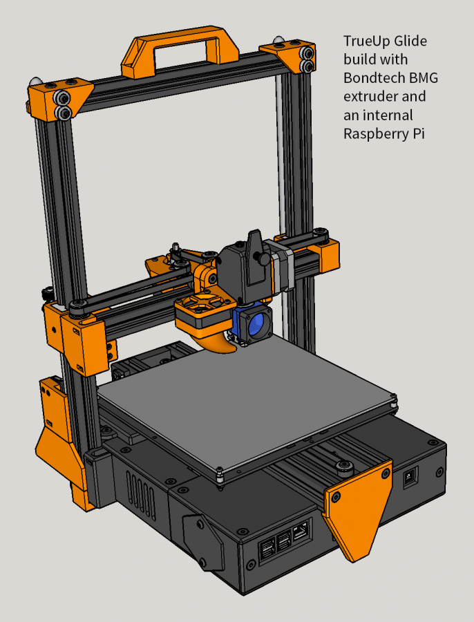

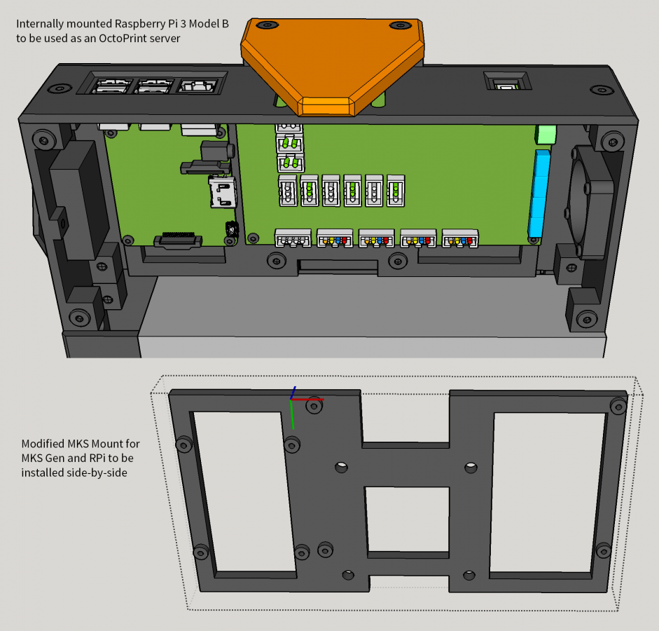

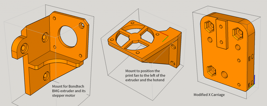

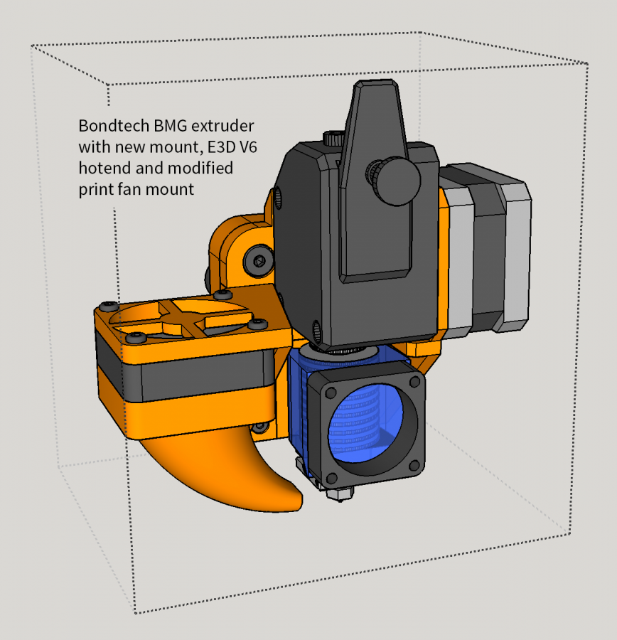

    Thought I'd mention here that I'm building a TrueUp Glide, but with some modifications, mostly that I'm using the new Bondtech BMG extruder (BMG Extruder - Bondtech AB) which involved creating a new mount, as well as major modifications to the X Carriage and a new Print Fan Top mount (the print fan is now located to the left of the extruder). I've also tweaked many of the printed parts and combined several of them (eg. the Y Motor Mount and the Y Limit Switch Mount).
    The other big change is that I'm integrating a Raspberry Pi 3 Model B (the one with built-in wifi) into the control box since there seems to be just enough room for it (with the original control box dimensions, not the new smaller revised-for-the-kit control box dimensions). This way the printer can run its own OctoPrint server for itself and/or several other nearby printers. A short external USB A-to-B cable will connect the MKS Gen to the RPi. Hoping to power the RPi with a jumper from the MKS Gen's 5V headers to the RPi's GPIO pins 4 & 6, as long as it can provide enough current.
    If there's interest in any of my source files or BOM, I'd be happy to share them.

    Thanks. Right now I'm only going to post my extruder/hotend assembly files (see attachment) because I'm still making some small revisions to other things. I haven't tested the modified X Belt Keeper yet, but it should hook into the teeth of the belt instead of just crushing it. Here's a question: Should these parts be printed in something with higher temperature tolerance than PLA, or does that not matter?

    PLA should be fine, the bondtech is removing the heat before it gets close to the mount.
    The belt keeper teeth are a nice touch, but unnecessary, even a nema 23 pulling against an obstruction on the X axis would not have power enough to slide the belt once it's tightened.
    Once you have tested this, be sure to put the mod on Thingiverse.
