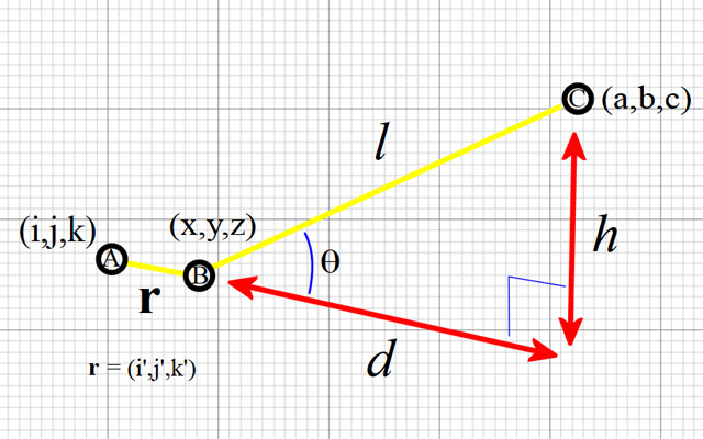

    Ok, thoughts:
    1) Big thumbs up for WWII-style concrete machinery. :thumbsup: That idea is in my future too, at some point, most likely on a metal lathe though I may try it on the mill that I have planned next (which itself is to help build a laser cutter next year!). I'd like to find a more environmentally-friendly alternative at some point too, but it works for the time being.
    2) Are there prepackaged delta-bot control systems, or are you going to have to come up with a novel method of control? I see a whole lot of simultaneous trigonometry involved over the more simple Cartesian systems, given that it'll still have to run from Cartesian vector->step commands. It seems like an X-Y gantry would still have saved the space over an X-Y table, but allowed a far more simplified control system and ease of reproduction/maintenance. It's a bit late to be thinking about this now, obviously, but unless there are solid software/firmware solutions already in place, the next stage will be quite difficult. But I assume you've done your research as far as that goes.

  15. Rob Taylor
    Rob Taylor Master
    Dec 15, 2013
    1,470
    755
    No worries, it's an interesting experiment with hopefully very practical results. And it looks awesome, more like an industrial robot than most OpenBuilds projects.
    Well that's handy! That should be almost all of the way there, just needs a little adapting to milling- which I just had a thought about right now. The actual depth of a cut will be increasingly limited as you move towards the outside of the platform, due to the arms interfering with the workpiece, unless your milling head has its own separate Z actuator. The form factor is fine for printing and cutting, but I think you might hit some unfortunate limitations on milling. Looking at the image below, you'd have to perform some kind of check prior to hitting start, like integrate the arms' total under-volume over the entire toolpath and see if the model "pokes out of" that volume when they're superimposed in 3D space.
    I don't think you need to waste memory storing arrays, because the vector calculations for inverse kinematics on this are relatively simple- there are only two possible positions of each belt for any given point in space of the head, and only one that's higher in z (positive theta) than the head itself, so each arm can be calculated independently. If you assign the centres of the three hinges connected to the belts exact 2D coordinates from the bed, you're only solving for Z. For the other end of the arm, I'd probably use a constant to adjust from the centre of the head to the centres of the arm pivots for calculation purposes. If you're keeping it all positive for the 2D coords (ie. arbitrary "top left" of the bed is 0,0- or an assigned column hinge nearby) which is probably advisable with Arduino's limitations on variables, the calculations should be really quite straightforward:
    (i,j,k)+(i',j',k') = (x,y,z)
    |(a,b) - (x,y)| = d
    θ = cos^-1(d/l)
    h = l sinθ
    z+h=c
    where (i,j,k) is tool center location, the primed version is the constant transform between the tool centre and the pivot, (x,y,z) is head pivot location and (a,b,c) is column gantry pivot location. d is flat distance from pivot to pivot, or from the side of the head to the side of the gantry- the bottom of the right angle triangle. l is length of the arm, and h is the height from where d ends to the gantry pivot- the riser of the right angle triangle.
    ...Which seems a lot when it's for all three arms on every step, but I don't think it's an issue for even Arduino-level computing power. I'm assuming that the Arduino files you have do all of that though, right? There's still the issue with milling, though, particularly at the extremities.
    Nice, once you have that, a whole custom GUI to go with it will be perfect. Maybe an entire self-contained package that reads STLs and AIs and stuff too. But I'm getting ahead of myself.
    Awesome. Fiber bonding and rebar both, I think, for me. Rebar should protect the overall integrity as the fibers protect the local integrity. It would also reduce the size of the rebar that I'd need and bond more tightly to the rebar with the glass fibres wrapping around it.

    That's what I'm saying- because the arms aren't fixed like a gantry, but vary in their height depending on the head position, there could be problems with depth on certain models that appear to be compatible with the geometry of the cutter but actually aren't once it starts moving around:
    It works ok as long as deep cuts are only made in the centre. Of course, the size of the spindle+mount+Z-rail is also something other people have to bear in mind on their Cartesian projects, so I'm not sure it's so much a limitation as a difference. Just something I thought of, anyway, I don't think it'll be relevant in day-to-day operations.
    I'm not sure that you'll see a significant difference in speed between calculations and memory access operations, though it's probably worth experimenting with given that the trigonometry might be relatively heavy for it (I don't know, for example, how many terms it calculates the Taylor series to for the sin operator). Reflashing directly from a control PC (or miniPC) might be the best idea given Arduino's sketch size limitations.
