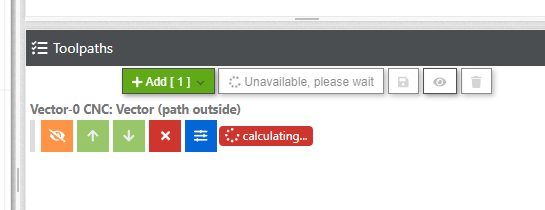

    hi it was working at first then now i cant seems to generate gcode. it will get stuck at calculating

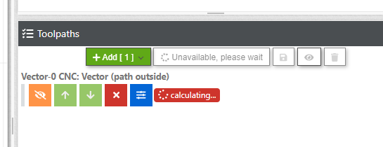

    here is my workspace

    That's OK, and doesn't affect Gcode generation. Been disabled as a feature since Disable Integration · OpenBuilds/OpenBuilds-CAM@100acae though the old Certs in CONTROL may still throw errors in console, not an issue
    Rightfully so, You can't cut at 0mm depth per pass :) - put in an actual depth to cut and it will be able to compute a toolpath for you
