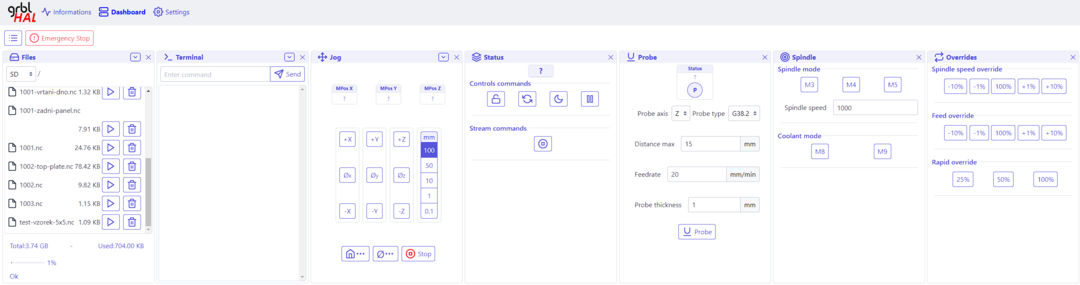

Hi, I just update BlackBox x32 with new firmware with OpenBuilds CONTROL v1.0.370. After Update Log / Serial Console detects board: Firmware Detected: grbl version 1.1f on 192.168.1.216 on WebGUI is v1.1f, but screen looks like this: no SD card, only some 960 KB storage, no controlling CNC machine... But everything works on OpenBuilds CONTROL if I neglect that the import of the settings did not go correctly. but I read everything from the TXT file and checked. I kept the new $xx parameters default. How can I downgrade? Or what I'm doing bad? Thaks!
You have to complete installation per GitHub - grblHAL/Plugin_WebUI: ESP3D-WEBUI backend for networking capable drivers/boards with SD card support In short: You must download index.html.gz directly via this link. Upload the file via the upload button in the FileSystem panel. This is the new V3 WebUI
Thanks again. It works. New WebUI is better. It would be good if this was added to the documentation (firmware update of BlackBox X32). Also, it would be great if it was possible to zero the axes via WebUI and based on XYZ Touch Probe Plus. Is it possible to set position to any XYZ value as in OpenBuildCONTROL?
