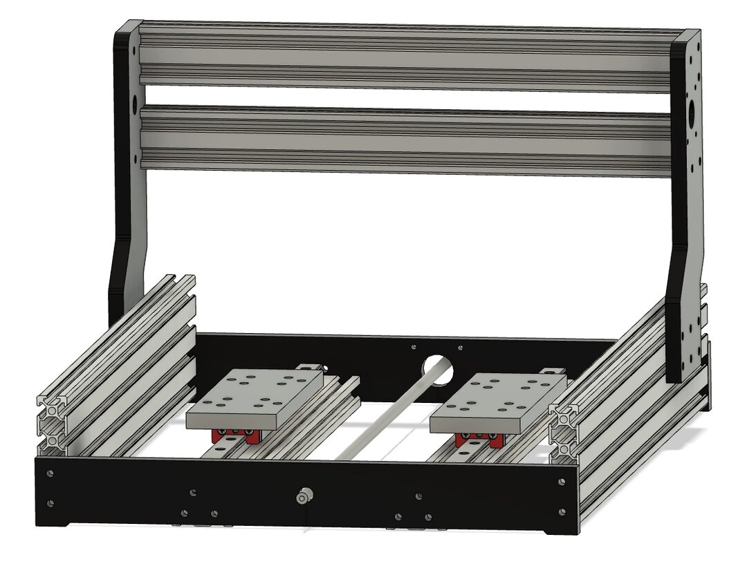

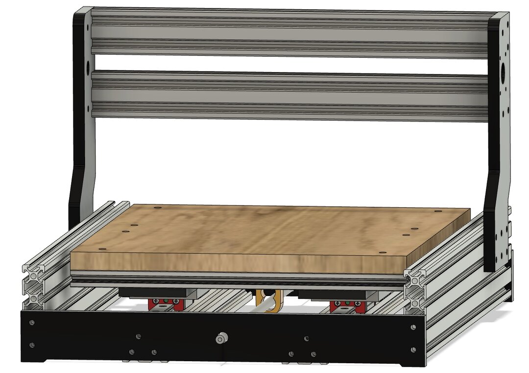

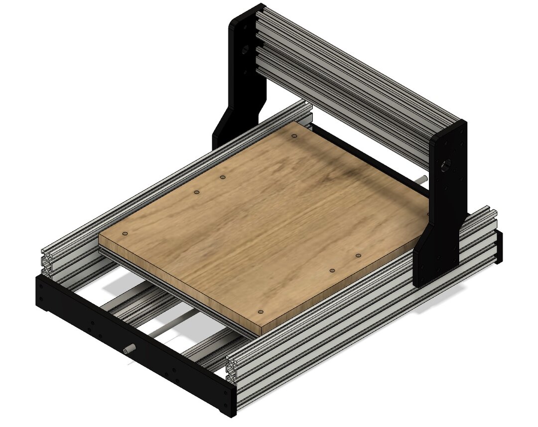

    So I didn’t order a mounting plate for the z axis because I didn’t think I needed one (I was going to reuse my existing one). However, my current one doesn’t fit the bolt pattern of my 65mm CNC spindle mount for the Makita.
    So I did what any respectable CNC owner would do, I designed and made my own.
    I decided to try out the Maker Store DLC coated 1 Flute 3.1mm end mill on this, and it’s a beast! It leaves a nice surface finish too.
    I do need to drill and tap the 4x M6 holes.
    screenshot 2023-05-12 at 3.58.12 pm.jpeg IMG_8524.jpeg IMG_8525.jpeg IMG_8526.jpeg

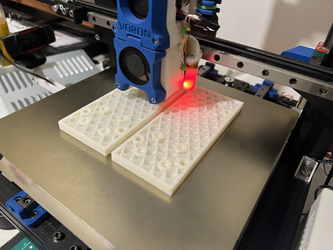

    In the meantime, I finished off my design for a 3D printed Relay and Power box for the Makita - It came out quite well, I think. The level lock terminal on the outside is for the relay to connect to my MKS DLC32 Spindle control. It’ll just be on off and should work well. For now, I’m just going to use the Dial on the Makita for speed control, however I might look into adding an RPM read-out to it, so I know what it’s set to.
