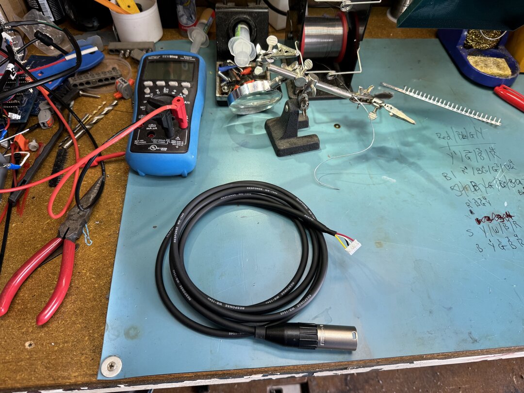

  5. dJOS_500
    dJOS_500 Journeyman
    Jul 16, 2022
    322
    131
    My first new stepper cable came out great! And my Z Axis now works! I just need to make the X and Y cables now. The XLR connectors pair perfectly with this cable - I guess I shouldn't be surprised seeing as it's sold as Microphone cable! :D

    I made an X axis cable cable and ran into an odd issue. I must have made a config error somewhere as it energises correctly, but then won’t move.
    Same result on the Y axis - X and Y use the same model motors. I double checked my wiring and it’s definitely correct and even matches with my old cables. I checked every connection with my multimeter and everything has continuity and minimal resistance. :(
    I might move on to the limit switches and come back to it.
  12. David the swarfer
    3,604
    1,976
    what noise doe sit make instead of moving?
  13. dJOS_500
    dJOS_500 Journeyman
    Jul 16, 2022
    322
    131
    None at all, however you can hear the initial energise sound and it does hold position.
  14. David the swarfer
    3,604
    1,976
    what are the max rate and acceleration settings?
  15. dJOS_500
    dJOS_500 Journeyman
    Jul 16, 2022
    322
    131
    Quite low, in fact identical to what I ran with regular GRBL.

  16. dJOS_500
    dJOS_500 Journeyman
    Jul 16, 2022
    322
    131
    It was a config issue, as soon as I connected my X limit switch, it started working. :duh:

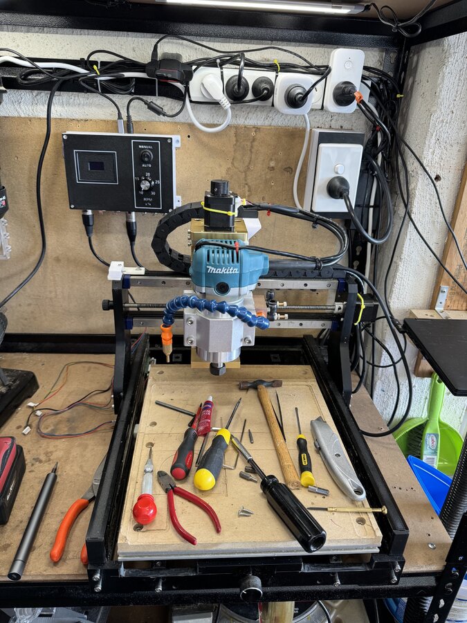

  18. dJOS_500
    dJOS_500 Journeyman
    Jul 16, 2022
    322
    131
    Loggy and David the swarfer like this.

  20. Loggy
    Loggy Well-Known
    Jul 16, 2023
    26
    19
    A wipe with tissue showed the parts weren't clean of grit etc.
    And disassembly showed they weren't as square and flat as they could be either. Work continues..
    dJOS_500 likes this.
