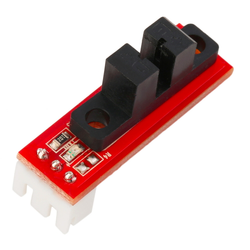

    I also discovered that one of my limit switches was broken and I didn't have a spare ... so I decided to buy some 5v optical limit switches from Maker Store. As my control board doesn't support the 12-24v inductive limit switches I bought a while back, this saves me the hassle of designing and building a PCB with optocouplers to get around the voltage issue. Hopefully optical limit switches be just as reliable, if not more so.
  19. Gary Caruso
    May 19, 2016
    1,204
    536
    Optical should work fine as long as you keep them clean, I deal with them everyday in my day job, they don't like dust.

  20. dJOS_500
    dJOS_500 Journeyman
    Jul 16, 2022
    322
    131
    Hmmm, that's a good point - my garage gets quite dusty so I think I might cancel that order and stick to switches.

    EDIT: Thankfully, Maker Store have awesome service, and I was able to change out my order of Optical end-stops to Switch end-stops of the type I’m already using.
