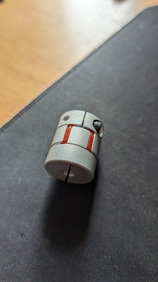

    Btw, I recommend you bin that solid coupler and replace it with something decent. I found the helical slit couplers to be excellent. They have the lowest backlash of any flexible couplers I’ve tested.
    eg Slit Style Couplings

    Have to check those couplers, mine came with those cheap flexible helical couplers, but I swap it right away for rigid ones.
    Have some other type here to try.

    Those couplers in your first picture are not flexible, and the jaw couplers shown below are IMO very poor, due to introduced backlash.

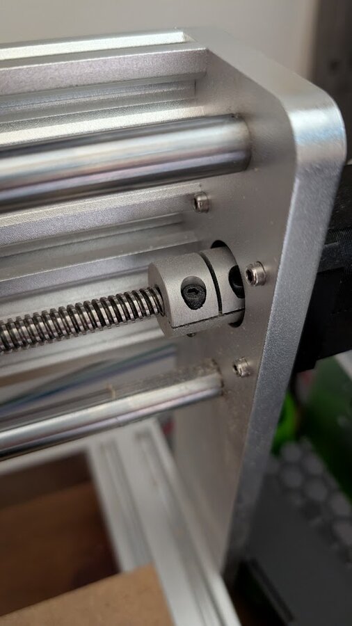

    This too a bit to start, In part due to lazyness, mistakes made and waiting for parts.
    But finally the upgrade is progressing.
    Have two SFU1204 ballscrews that were for another CNC project that never happened.
    With a bit of fiddling and testing was able to fit them in both X and Y (along with the Z slider) making it all running with ballscrews.
    I want to keep it at least locked in one side so had to design and 3D print an adaptor.
    Tried to fit the ballscrew mounting blocks, that would lock it on both sides but it was far too messy, lots of drilling that I have no way to do and far too many adaptations. For this phase it goes like this more about it later.
    As for the Y it asked for longer profiles but that also brings more work area.
    Went from 300min to 400mm profiles, but the ballscrew fits perfectly.
    Like this was easy to lock it in one side. Placing the pillow block on the inside.
    First mistake was on the Z slide car.
    Spindle mounting holes don't match, my mistake here.
    Picked the 3D CAD, 30 minutes later got one done.
    Printed and fitted, looks great but will be the weakest link.
