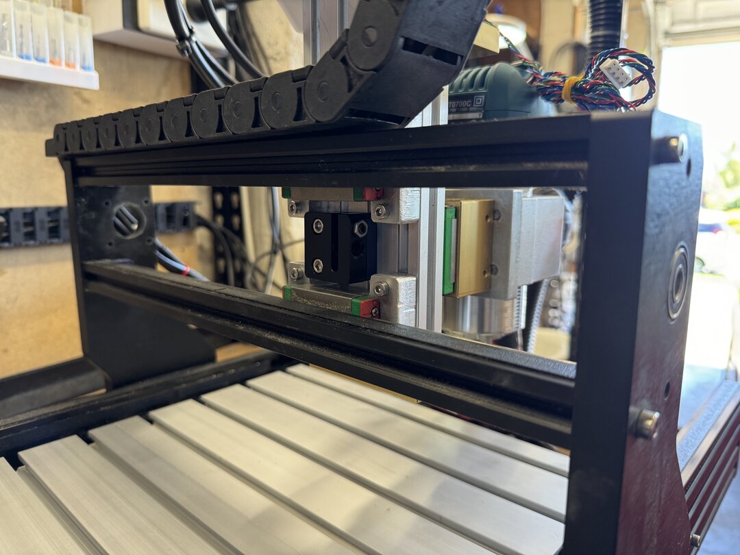

    I see you have made a 3dp spindle clamp. Is this made from ABS fillament? If not then do keep in mind when you run the spindle for long periods of time the heat it generates could affect the tightness of the mount blots thereby introducing inaccuracy in the cutting..
  2. dJOS_500
    dJOS_500 Journeyman
    Jul 16, 2022
    322
    131
    100% agree, ABS or ASA are the best options - even PETG will go soft from a hot spindle.

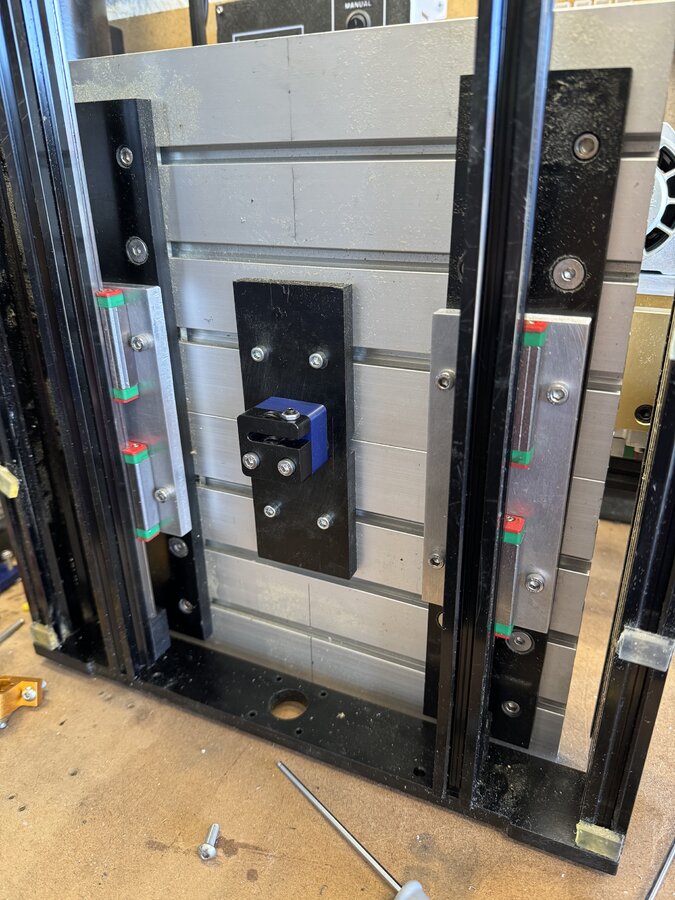

    I am curious to find out if by having two separate aluminium profile base plates and spoilboards joined together. Did you see and issues with the flatness (split between the two plates) after plaining the surface?
  15. dJOS_500
    dJOS_500 Journeyman
    Jul 16, 2022
    322
    131
    Surprisingly no, but I do plan to make a single piece aluminum bed at some point. I think that the black stuff tying the two halves together is pretty stiff.
    Upgraded 3018 Pro using MGN15H Linear Rails and a 500w Spindle
    As an example, I finished my carbon fibre bed carriage last week, and the 0.3mm deep mounts are perfect in each corner.

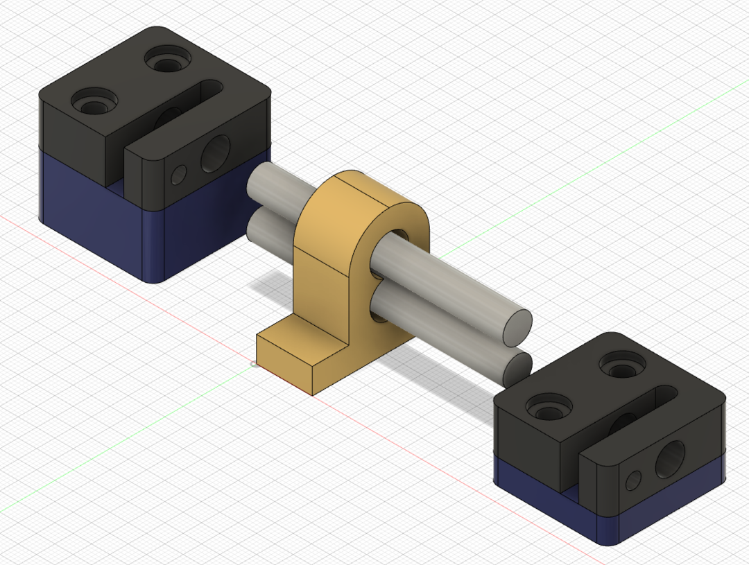

    I am looking at a used custom built fixed gantry cnc router for upgrading. It uses v-slot profiles and has 2 x 500mm SFU1605 ballscrews and has a workarea of about (y) 365mm (x) 290mm.
    My plan is to change the 500mm ball screw on the y-axis with a 650mm that I have lying around.
    I was trying to calculate the size increase but I think there is more to it then just deducting the additional useable threadsize of a longer ball screw, which is 42mm less then the actual lenght. Am I right to think one has to also take into consideration other factors such as the mounting position of the fixed x-axis gantry?
    If anyone who has experience of designing XY fixed gantry cnc machine, would appreciate some help on the above as to how much (y) travel increase a 650mm ball screw provide compared to 365mm for a 500mm.

    I’m yet to design my X/Y ball screw upgrade, but I think the best idea is to model it in cad. Then you can move the bed assembly around to work out the actual work area.

    Thanks for the reply. Still a novice when it comes to CAD but will try and watch a few YT videos and create a model and report back my findings..

    You could try mocking it up in the low tech CAD, cardboard aided design? That method can be very effective.
