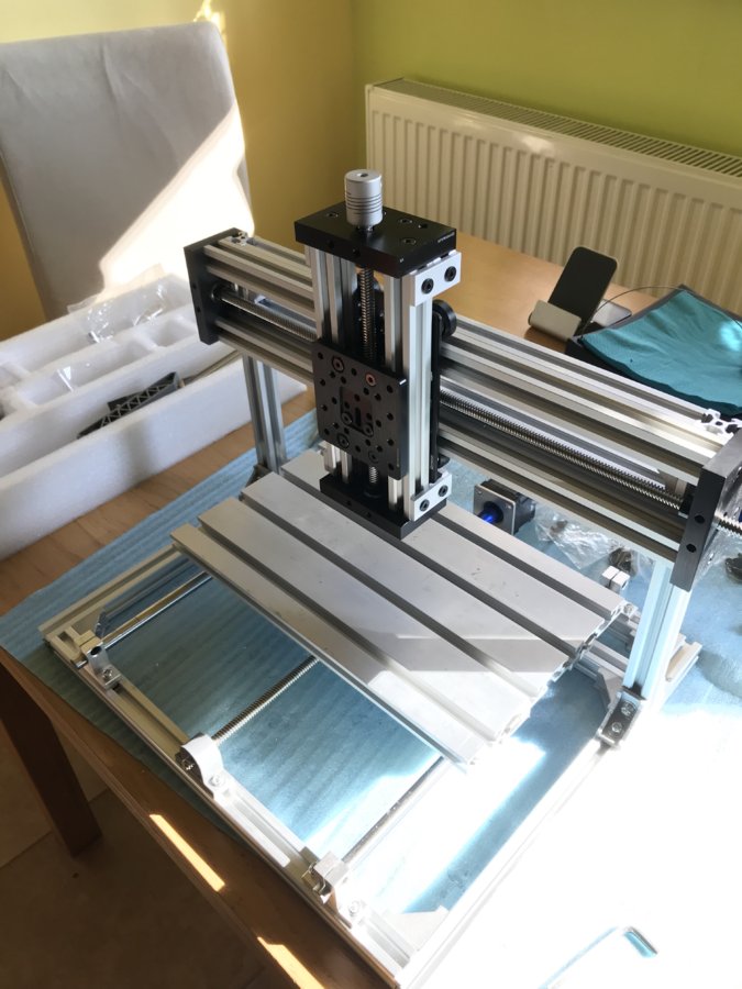

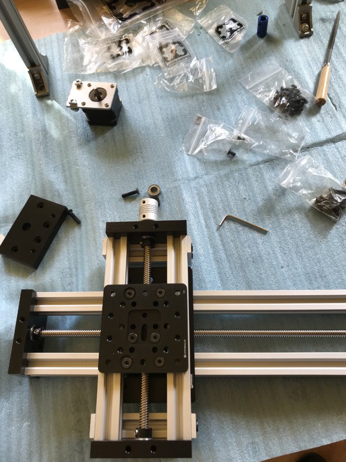

    I've finally received all the parts (including new spindle with it's own controller and power source). Everything seems to go together quite nicely, except for one thing: the X lead screw isn't perfectly true and as such feels a little wobbly(?) when turning it by hand. This may not be an issue for the stepper, but I'm concerned about wear on the anti-backlash nut in time.
    Here are some pics of the whole build.
    I just have to fabricate some brackets for the steppers now and a plate for the spindle (I'm thinking about a 6mm alu plate for that one).
    Michael.M likes this.
  27. Michael.M
    Michael.M Veteran
    Jan 21, 2017
    432
    267
    I would also consider replacing those vertical extrusions (holding the z & x axis up) with something like 20mm x 60mm extrusions to increase rigidity and reduce deflection. You could also add some angled supports or gussets. The top x & z axis are looking good though.
    Actually, what size are those original extrusions? 2020?
  28. CatalinM
    CatalinM New
    Dec 22, 2018
    20
    Yeah, the original extrusions are 20x20, but they do have angled supports... they just weren't mounted yet when I took the pictures.
    I'm still concerned about the x axis lead screw not being straight. Any thoughts on this?
  29. Rob Taylor
    Rob Taylor Master
    Dec 15, 2013
    1,470
    755
    Screws not being straight is somewhat normal, really- maybe from shipping or storage, I dunno. If you have something that can serve as an arbor press and a dial indicator, you can push it back into straightness. This also sometimes has to be done with ballscrews.
  30. Michael.M
    Michael.M Veteran
    Jan 21, 2017
    432
    267
    I straightened out a couple of my ballscrews using a couple of v-blocks and a dial indicator. Google will provide some examples but just how bent are they?
