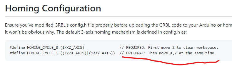

    I am trying home x and y in 1 cycle as shown on the internet, but cannot find access or location of the config.h file using Blackbox. Please help.
  2. sharmstr
    2,059
    1,449
    Not exactly sure what you mean by x and y in one cycle, but if you want to have a custom grbl config, then you need to compile it yourself. Here's how: Compiling Grbl · gnea/grbl Wiki
    Once you have your custom firmware compiled, you can use Control to upload by going into Wizards and Tools -> Firmware flashing tool.
    Be careful and follow the directions. Lots of people screw it up.

    If its an advanced, custom homing sequence you are after, you'll have to compile yourself
    But if its one of the more standard, popular things, we provide a couple different precompiled options directly in the Wizard (For example, if you mean ONLY XY homing for a Laser - ie No Z axis - we have the 2axes option right there in the wizard; Building a plotter and need the Servo feature, it's in the wizard; Want to enable the compile time Door interlock options? It's in the wizard)
    David the swarfer and sharmstr like this.
  5. Larry Paige
    Dec 18, 2017
    13

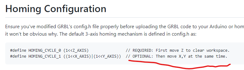

    This is what I wanted to do, but seems too complicated now.
    15,257
    4,354
    Grbl already homes Z first, then X and Y together. The word Optional there is just documentation wise. If its uncommented, its active
