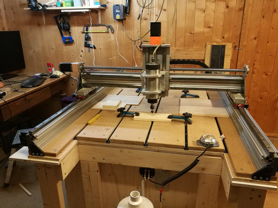

    If you use 1/2 inch ball screw, you get whip. 1/2 inch = 12.7 mm. I used 12mm ball screw on my OX. But because of the whip I upgraded mine to 20mm.
    Her is my OX today.

    Did you use 2005 or 2010? I see everyone using the linear rails but I already bought all the v wheels so I don't want to switch now.
  14. Knut Bøje
    Nov 20, 2014
    20
    23
    I'm using 2005.
