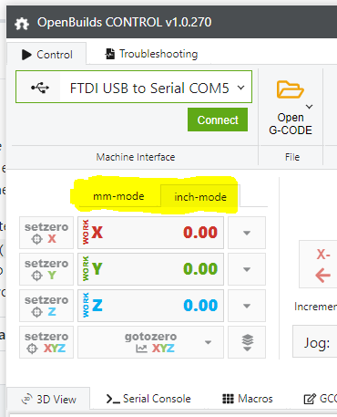

    Hello everyone,
    Pretty new to cnc-ing something happened to my software.
    In the open builds software I had everything set up in inches and when I went to switch tools for some reason it switched to mm. I dont even know if its mm. (ill attach a picture of it on 3d mode and it shows 200 on the x and y)
    Also when I load a file I dont see it anymore. It just shows a dot on the bottom left.
    What did I do?? please help
    Builder Resident Builder
    15,700
    4,508
    Never change $13, please keep it on $13=0 (Disabled) or the values will be incorrect. Grbl is metric internally.
    The mm/inch mode tabs are right above the DROs:
    Post the file so we can check

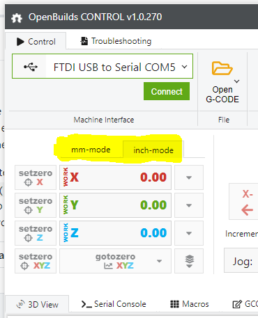

  3. orellana.arch
    May 18, 2020
    Oh wow that makes sense why it wont switch to inches. whoops
    For the picture you posted I do have mine at inches but the bottom on the 3d view it still shows 200 on x and y
  4. orellana.arch
    May 18, 2020
    Also when I import a file I cant see it anymore I even tried switching the file into mm and still wont work
  5. orellana.arch
    May 18, 2020
    This is all I get when I upload a file
    15,700
    4,508
    As I mentioned before, post one of the files so we can see if loads here
    The viewer units updates according to the gcode file, i.e the tabs set how you jog, how the DROs are shown, etc, but the viewer reacts to the file loaded.
    You can jog in mm, and run jobs in inch for example. Neither are ever exclusively set. The machine will honor what the gcode says it is (G20 vs G21)
    So if it stays on 200x200 theres a problem with the file . Please upload it

  7. sharmstr
    2,059
    1,449
    In your first post you have mm selected in vetric for the post processor. :)
  8. sharmstr
    2,059
    1,449
    Also, I dont have experience with this, but can you actually "output direct to machine" from Vcarve to Control?
  9. orellana.arch
    May 18, 2020
    wow wth thank you guys lol I had it saved on mm. for some reason when i just got the machine i had to save it on mm and it will display it in Inches. once I updated the software that mustve changed. idk but thank you guys so much lol
