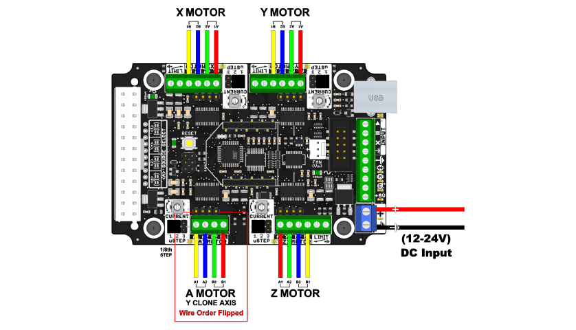

    We finished assembling and wiring on our WorkBee 1510 (thanks for the helpful videos!) All wiring components are working. However, I had originally set the X- and Y-axis maximum rate to 10000 as the settings page indicated, but had significant vibration on homing and other movements (see video) until I set the Y-axis speed down to 1500. Though 10000 is more than necessary, operating at 15% of that max speed seems limiting and potentially problematic. There are no obstructions and the belts appear to be tensioned correctly. The noise seems to be from the right Y-axis. Is this a belt or step motor problem? Any ideas?

  4. Mark Carew
    2,785
    2,492
    Hello @Grimace
    Congratulations on your Build and thank you for your compliments on the Build videos!
    Lets try a few things to get you up and running:
    -First I would say to turn off all power and make sure that each and every wire has a good solid connection, one loose wire can make for this kind of behavior and this accounts for many drivers getting burnt out as well. Also on the 1510 make sure that the wires are properly reversed on the clone side of the Y axis as shown in the picture below.
    -Second make sure that your board is being cooled as these motors like to pull amps which heats things up and can keep your board going into a thermal protection.
    -Third make sure that your driver board is set up for 1/8th steps like the default is in the video, If its an xPRO you want the jumpers on 1 and 2 for each of the axis.
    p.s. One of the coolest features about OpenBuilds is that its a virtual hackerspace of sorts and so you will get better responses if you post a question related to this machine in the machines discussion thread (WorkBee 1510) where like minded builders who are building the same machine will be hangin out. This helps others who may run into similar hurdles along the build learn as well.
    Hope this helps
    Mark

    when I added the wire extensions (18-4) for the 4 motors I checked resistance on each and all seemed OK (around 1.5)
    Mark,
    --Checked all the wires-OK
    --Have a fan on controller. Same effect occurs when board is initially powered up.
    --Jumpers are still on 1 and 2.
    I tried alternately removing the Y-ax and the A wires to test each separately and still had the problem.
    The X-axis runs perfectly at 10k. The Y-ax appears to be most affected at each end; less so in the center section. I removed one end of the left Y belt to inspect; no apparent shredding, etc.. Belt tension seems OK.
    When I move the Y-ax manually, it makes the noise and a red light on the controller flashes. (see Y-ax (manual move) video). What does that light signify?

  7. Mark Carew
    2,785
    2,492
    Hi Grimace and Gray
    Too me it sounds like bad driver. I say that because it seem it seems to happen right out of the gate after you initiate a move command and the motors begin their wind up. This seems to happen no matter where you are on the rail. Because of this I would rule out mechanical issues. This coupled with the back feed of moving the ganty around says to me there is a bad drive there.
    I would love to get my hands on that board to test out and see if thats the case. In the meantime so we can get you up and running asap we will send out a new xPRO driver board.
    I will reach out to the part store and let them know the situation and that we are troubleshooting it and they will set you up with a new one and a return envelope for you to send back the original board.
    I will use this information to help better the instructions in the video to warn about the backfeed so that builders are more aware of it.
    Sorry for the troubles you are experiencing, CNC'ing is really is a lot of fun once you get up and cutting.

    As the problem seems more pronounced at the ends, I was starting to believe that the rails weren't parallel, or the beams were dog-legged causing the wheels to tighten at the ends. That seems unlikely though, as the engineering seems to allow for little variance. This is my first foray into CNC, so I'm just trying to parse the possible from the likely! My fingers are crossed that Mark is right and it's the board. If not, I'll have to begin deconstructing the machine. After getting this far, that would be a downer! :cry:

    If you didn't send the board yet, please hold up and watch this video. After reading GrayUk's post I tried running at 10k with a light assist on each Y-axis side. This seemed to fix the problem. Would this indicate that the beams are not squared?
  14. GrayUK
    No, I would say that is due to the load, and its ability to handle it. :rolleyes:
    Do you get the same effect by helping the other side?
    Try loosening the grub screw on one of the Pinion Timing pulleys so that it is free on one side and see what happens. Just help it so it doesn't dog-leg.
    I still have a gut feeling it is low amps. :confused:
    Take advantage of Mark's offer, if only to eliminate the electrics and program side. You can always send it back. :D

    I think the problem is solved! I went over the wheels (again). I noted that some opposing wheels were at very different levels of contact. One at the top was spinning freely while the one at the bottom was tight (or vice versa.) I went back and turned all of the eccentric spacers to the maximum looseness and ran the Y-ax at 10k. Seemed to be on the right track. After several rounds of adjusting the six eccentrics on both sides and at different positions on the Y-ax, trying to compromise between the upper and lower wheels, I have no more vibration. The videos shows the results.
    I still have opposing upper and lower wheels that are at varying tightnesses. Some spin freely while the other side is tight. But if I adjust the eccentrics to the correct the one, the opposite side over-tightens and seems to pinch as it moves down the Y-ax. I believe that's why it was acting up more on both ends.
    I will do more testing tomorrow to verify the fix, but the board doesn't seem to be the problem.
