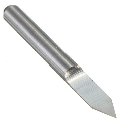

    Hi Francis,
    Thanks for taking the time to respond, and thanks for the links. It's not the 'regular' type of V-Carve router bit that I'm after.
    I've now realise that they're actually known as 'Engraving' bits, they've got a flat side to them like in the picture below >>
    So far I've only managed to find them on Amazon, eBay and sites like Bangood ............. probably cheap garbage that'll break the first time you use them ! Do they not make quality bits like these ? I'd like to buy all my cnc bits under one roof but that's proving to be quite difficult. Would you say that it's OK to use eBay and Amazon bits for general cnc stuff ?

    Turk - not used these guys but might help: 2D and 3D carving, engraving and lettering router bits, solid carbide and tipped | RouterCutter
    I've been buying cheap off the bay but having problems at present with breakages. Mind you the cutters are 0.6 and 0.3 mm so I'm slowing the feed rate down and reducing cutting depths at present but I think it might be the router that's the problem (run out), so looking at getting a smaller water-cooled spindle 0.5 - 0.8 Kw as I don't need heavy cuts (save my ears too!)
