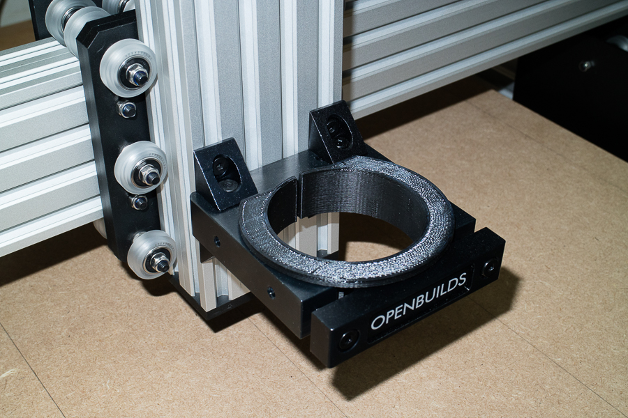

    The list of ooznest AVAILABLE OPTIONS is indicated by: mount + makita RTO 700
    Can not you say that this is a perfect mount 65mm if you have the extra cylinder makita?

    I'm not sure I understand the question Pauna, if it's a question at all, or maybe just a statement. Would I say it's 'perfect' ........ not at this stage, as I haven't used it in anger yet ! But it is a perfect fit for the Makita RT0700 that has the 65mm barrel :thumbsup: Sorry, don't know what you mean by 'extra cylinder makita' ..........

    I'm interested in the mounting bracket for the router from 71 mm to 65 mm for your production? As I think, this detail is made on a 3D printer
    If it is made by ooznest?

    Yes it is, 3D printed part, It's very very hard plastic though.I don't think that Ryan has put it on his website yet, but he does supply them through Ooznest, just give him a call I'm sure he'll sort you one out :thumbsup:

    It is interested that in the list there is ooznest. mount + makita of RTO 700C.
    Other parts of mount or 3D - the press which you have....

    @pauna Regarding the shim, if you want one, give me a shout and i can sort you out.

    I have financial issues to be resolved and at the beginning of the month I will buy WorkBee CNC 1700X1700, I will definitely need the shim ...
