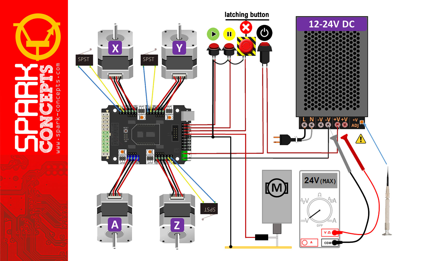

    Great build! I have my screw driven Workbee built and partially wired, but I cant find diagrams for Arduino and CNC shield for wiring the pause, play, and emergency stop up to the power supply and the shield. In fact if you can point me in the direction of a good resource for Arduino CNC shield diagrams in general I would greatly appreciate it.

    Hi, nice build! I am looking for wiring diagrams for the emergency stop, pause, play, from the power supply to Arduino CNC shield. I build a large screw driven workbee and I am trying to drive it with Arduino CNC Shield, like you but it is very hard to find wiring diagrams. I think I have it for the motors and limit switches, but not the emergency stop. But if you have good diagrams of motors and limit switch placement and wiring I would take those too. Ooznest and the Open builds seem to be putting the limit switches in very different places.

    Your shield has these labeled as to where to plug in your switches and if it is a Protoneer designed board version 3.1 it will be accurate for GRBL 0.9 and on. If it is a Chinese clone it will most likely be version 3.0 or less and the spindle pwm and z axis pins will be reversed. All those pins are associated with the arduino outputs in the wiki. If new to GRBL, I would suggest reading this entire wiki because it will save frustration and answer almost all your questions down the line. So, since you are just looking for a diagram on how to hook up switches, use the Xpro diagram, but plug into the corresponding arduino cnc shield pins.[​IMG]
    On my CNC, the Esto[ is wired in series with the on/off switch. If I have an emergency, I wanted all power cut. But that was my personal preference and made wiring easy.
