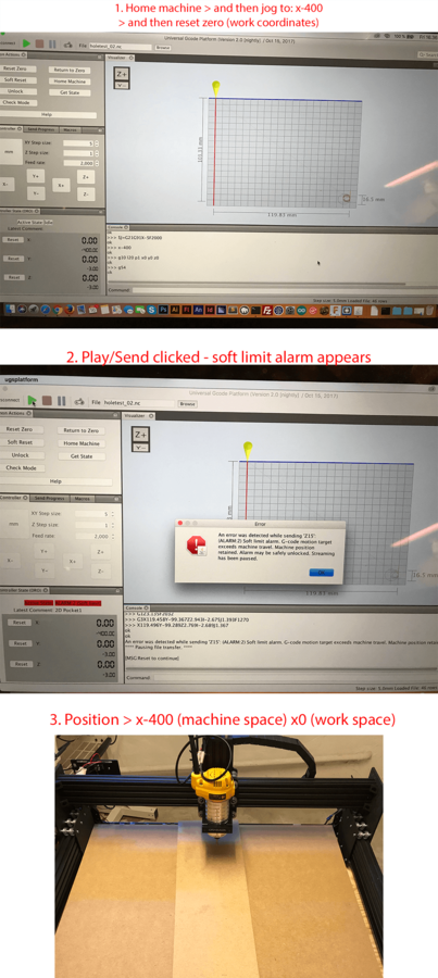

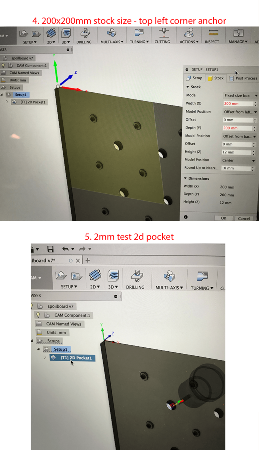

    Finally got around trying to test some g-code on my 1000x1000 workbee, but encountered some issues in UGS with soft limit alarm. Im hoping someone could give me some input as to what im doing wrong?
    I'm simply trying to do a 2mm 2d pocket on a defined stock at 200x200mm (anchor top left) (see the images below + attached g-code).
    I homed my machine first (-3, -3, -3) > moved to x-400 (machine coordinates) > reset work space to zero > tried to run the g-code > and soft limit alarm appeared.
    With the test setup I did, it seems I should have lots of movement space on both X Y Z axis?
    Did also setup the GRBL settings (screw driven) as noted in the setup guide.
    Im getting the following error:
    "An error was detected while sending Z15: (ALARM:2) Soft limit alarm. G-code motion target exceeds machine travel. Machine position retained. Alarm may be safely unlocked. Streaming has been paused"
    Disclaimer: im all new to this
    The soft limit error
    the g-code setup
    Edit: attached single images for better view than the thumbnails
    #305 spandadk, Mar 16, 2018

    @spandadk When zeroing your machine, is the tip of your cutter touching the top of the material? From looking at your fusion360 screen shot this is where the Work zero should be set. But looking at your UGS screenshot Work zero on the Z is the the a machine zero. You could set $20 = 0, this would disable soft limit alarms, but the machine most likely would go into a side plate or go to high. But you could give it a dry run with it set to 0, and see if it does.
    @Lee Jackson You could also check the above.
    @Paul Rapson There is a good chance it is a static issue. What material are you cutting? Is the Router wire and USB Wire outside the drag chains? You could try another sender program like GRBL Panel.

  15. Lee Jackson
    Oct 9, 2017
    Thanks Ryan, got the problem sorted I didn’t have enough Z clearance, I repositioned router and all good, happily carving away now.
