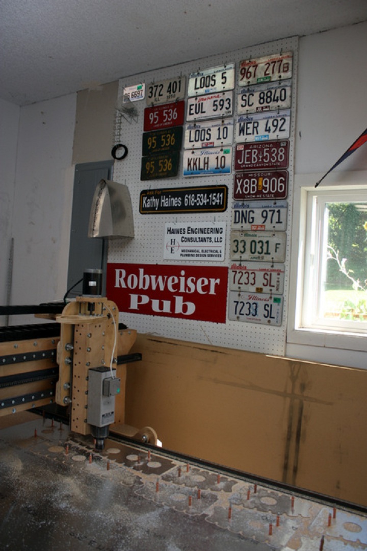

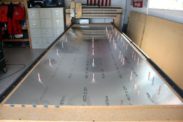

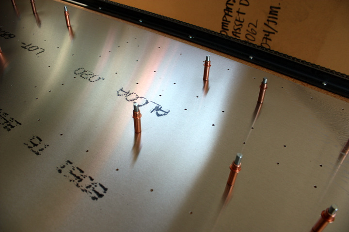

    Ok so here is what I want to emulate. The sheet is laid out on the table. Holes are drilled though the sheet and waste board. After hole is drilled a Cleco is installed to hold the sheet down. All the needed clecos to hold parts down as they are routed are installed. Then change bit and route out the parts. So my worry is when the machine jogs between parts how do I ensure the bit does not hit the cleco. Only way I can think of is the Z is lifted high enough it clears always, but unsure if there is enough Z for this in the Workbee. There are low profile clecos I can buy to help if needed.
    Thoughts on doing this with a Workbee? I can get by with a 1000 x 1500 machine or possibly a 1500 x 1500. Any chance I could buy longer extrusions and build up a 1500 x 3000mm machine or 1000mm x 2000mm.

    @halfshavedyaks Yup i think you understand. So yes if you machine you a big enough pocket to accommodate the router and extrusion you could go deeper. We say the above for simplicity.
    @Cloudbase Engineering So yes you could have a Z Safe height clear them. Or make the code so it misses them. You could raise the machine up to gain the extra heigh.

    Hey Scotty and CNCKitCompany,
    Thanks for the suggestiions but I am thinking you have never used a Cleco because they are the bet thing since sliced bread for sheet metal work holding. I Use them in so many places that they were never intended otbe used since they are so veritle. There are many types and worth a look.
    Anyhow here is a video that explains it all:
    Marc
