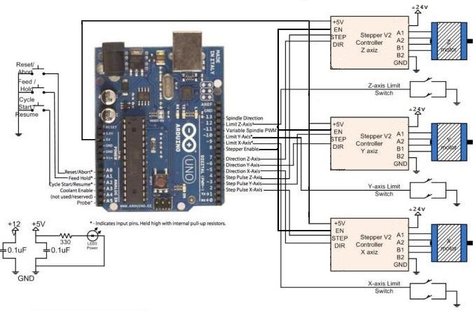

    33
    Do you know where I can learn to wire this thing? I havent been able to find any diagrams for the arduino and dm542t drivers

    Come on, Jacob, you don't know how to use Google? Ten seconds on Google brought up the photo below. (Although I prefer to use a +5 based wiring scheme for the drivers, connect all the + inputs to +5v on the Arduino, and all the P+D outputs to the - inputs on the drivers. You'll have to invert the driver signals in the GRBL settings.) Do not connect the ground pins to chassis ground as shown!

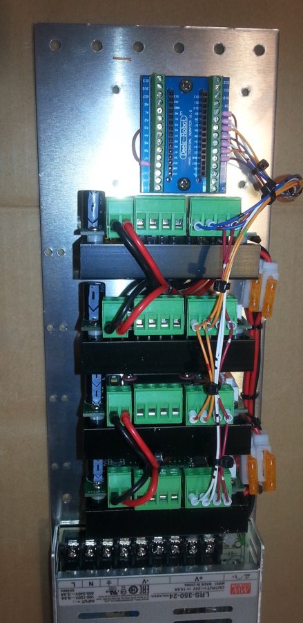

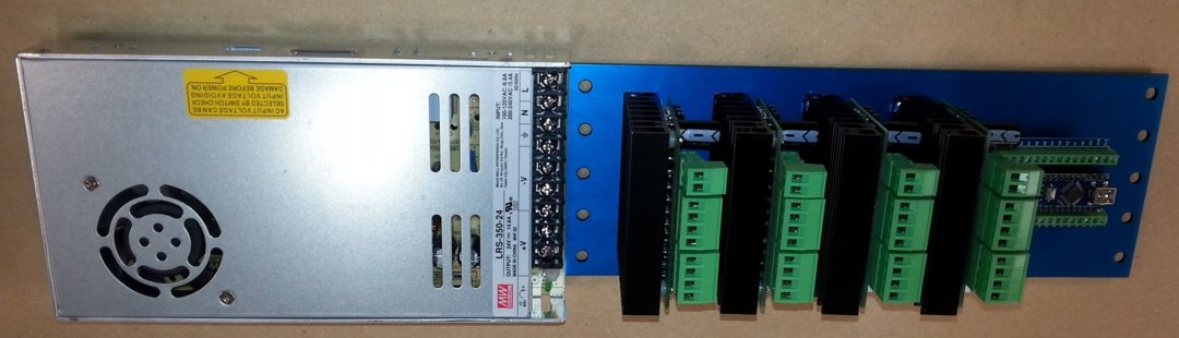

  15. John Mayer
    Aug 17, 2018
    24
    Thanks for the quick response!
    I can see fuses and capacitors?
  16. joe williams
    joe williams Well-Known
    Nov 9, 2015
    100
    59
    From what I've seen of Metalguru's usual setup,. the fuses are inline on the positive DC lines from the power supply to each drivers' +DC in....the caps in the above pic are already existing on the driver boards if I'm not mistaken.
    @Metalguru ,...Are you using 5 amp fuses in this application?
  17. Metalguru
    Metalguru Veteran
    Dec 29, 2015
    751
    549
    Yes. The fuses are 5A automotive type blade, one for each driver. Separate power and ground lead for each driver back to the power supply. Just a precaution to prevent a fire if a driver goes south.
    And yes, the caps are on the driver boards.
    MG

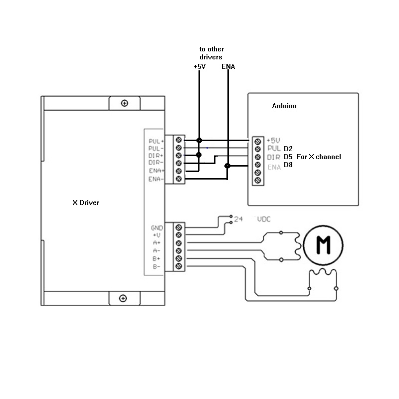

  22. Metalguru
    Metalguru Veteran
    Dec 29, 2015
    751
    549
    See the schematic above. VCC = +5V
    Tie all driver +5v pins together to +5v on the Arduino.
    Tie all driver ENABLE pins together to arduino output D8
    The DQ542 is one of the drivers I referred to as having both + and - terminals for each input. On each driver, you have to externally connect all the + terminals to +5v, and all the - terminals to the respective Arduino outputs. The outputs then need to be set for Active Low.
    You could also wire all the - terminals together to Arduino ground, wire the + driver inputs to the Arduino digital outputs, and set the outputs on the Arduino to Active High.
    All of the +5 or Gnd terminals on all of the drivers have to be connected together, depending on which setup you use. Also, all ENA pins on all drivers have to be connected together to D8 on the arduino.
    Refer to the DQ542T Manual for more information.
    MG
    #412 Metalguru, Sep 8, 2018

  25. John Mayer
    Aug 17, 2018
    24
    Can you please do me a favor and check if I get this right?
  26. Metalguru
    Metalguru Veteran
    Dec 29, 2015
    751
    549
    Uh, no, not even close. Don't hook it up this way, you'll blow stuff up! Try this one. Same except you have 2 Y drivers just wired in parallel. Also, since your driver has separate + and - connections for each input, wire all + connections together to +5, and all - connections to their respective arduino outputs. Again, READ THE DQ542 MANUAL, its on the OB store DQ542 page.
    MG
    #416 Metalguru, Sep 11, 2018
  27. John Mayer
    Aug 17, 2018
    24
    Thanks for taking the time to check my setup. However, this is were I get confused "wire all + connections together to +5" My step driver don't have a designated +5V pin, it has +5 Pul, +5 Dir, and +5 Ena. I know that I need to connect +5 Pul to it respective Arduino output.
    +5 Dir to respective Arduino output.
    That's leave me with +5 Ena's which I need to connect together and then to the D8 in the Arduino output.
    They only other output pins I have left are the -5 Pul, Dir, and Ena which I need to connect together and then to the ground in it respective Arduino output. Am I getting it right?
  28. Metalguru
    Metalguru Veteran
    Dec 29, 2015
    751
    549
    NO! WRONG!
    "wire all + connections together to +5" How is this in any way ambiguous? Connect everything that has a + sign in front of it to +5V terminal on arduino. Nothing Else! That means you will have 12 terminals on 4 drivers connected to +5V. I don't know how I can explain it any simpler... Just like this diagram:
    And no, you don't connect ANY pins marked + to ANYTHING but 5V.
    All pins with a - sign in front of them go to the Arduino outputs:
    If you still don't get it, I give up.
    MG
    John Mayer likes this.
  29. SugarJ
    SugarJ Well-Known
    Nov 16, 2015
    126
    47
    Also note that you have to set $2=7 to invert the logic on the X, Y, and Z Pulse ports so that it drops the signal to 0V to send the signal. (Active Low). Default configuration is Active High.

  30. John Mayer
    Aug 17, 2018
    24
    Thanks! I got it this time!
    I was thinking that I need to connect the + pins into the arduino the whole time. Thanks for your time, patient and explanation! :duh::D
