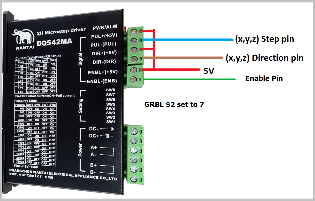

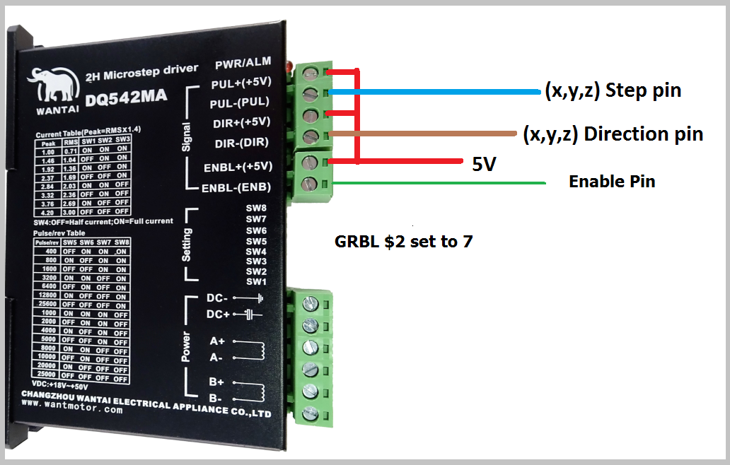

    You could wire it up in the reverse direction as well, with +'s connected to Arduino and -'s to ground, but I didn't want to confuse the issue further.
    As SugarJ pointed out, you do need to set $2 to 7, and also you will likely need to set $4 to a 1 as well, since the Enable lines are active low. If any of your motors turn backwards, you can either reverse one of the motor phases (ie red and green), or use the $3 to invert the direction of the motors.
    Note: Do Not unplug the motors or power from the stepper drivers or change switch settings with the power on! You risk blowing the drivers if you do.

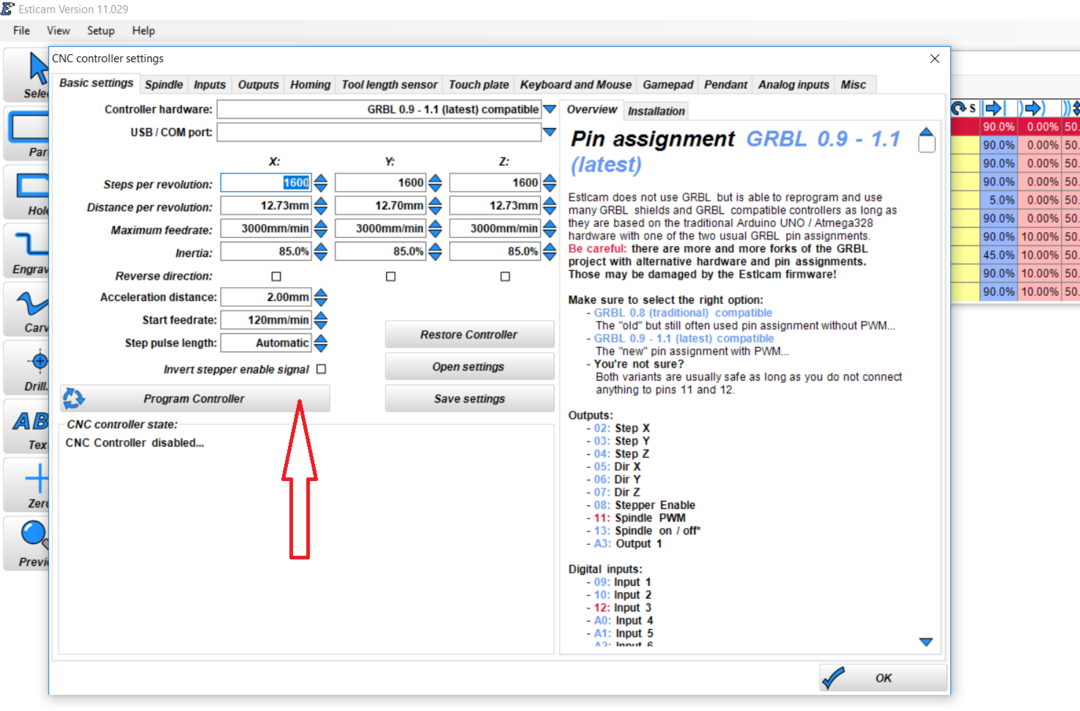

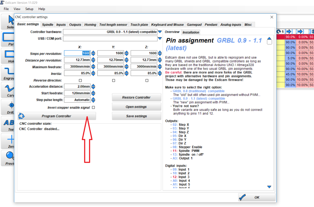

    After all your help I was finally able to wire the step drivers. I was trying to do a run test to make sure everything went well. I programmed the Arduino with GRBL, then tried to jag the motors individually. I tried both Uno and Nano, all axis motors work with the Uno, only the Y and Z axis work with the Nano for some reason. I have tried different Nano and different screwshiled with the same result. While
    X axis not physically turning it's showing that it's jogging fine within the software. Y and Z axis are working they only turning in one direction i.e clockwise or counterclockwise and when I reverse the wires the start turning only in the other direction.
    I have also tried to test the Estlcam program on both Uno and Nano using the 2 GRBL settings, GRBL 0.8 (traditional) and 0.9-1.1 (latest). I am not able to control any of the motors with Estlcam.
    Any thoughts on hints to put me in the right direction?

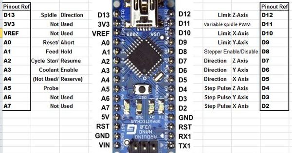

    Nor sure what the problem would be. There is no reason why it should not work with a Nano but does work with an Uno. Even the pinout is exactly the same. Unless you have 2 Nanos with the same fault?
    The only thing different is the configuration file on the board. Check to make sure all your settings are the same. The only other thing I could think of was an intermittent wiring fault, but that's pretty unlikely. Did you try swapping the X and Y axis or X and Z outputs to see if it works? Do you have a scope that you can check the output of the Arduino board with?

    I did program both Uno and Nano. The EstlCam recognized them as if they were programmed and show them when I try to tluse the controller, however it can't move any of the motors

    What do you mean "I can't manage to get any voltage out of the Nano once it connected to the DM542 drive?" Does your 5V drop to zero (or below about 4.5V) when you connect it to the DM542 or what? If so, that is likely the problem. Have you checked and double checked the wiring? Is GRBL setting $2 set to 7? Try using a USB3 port on your computer if you have one, they can supply more current.
    The DQ542 manual shows as having 200 ohm series resistors on the input lines, in series with the LED. At least in one diagram. In the other diagram, it shows 270 ohm. Not sure which is the actual value. This means each input LED will draw less than 20mA. With a possible 12 drivers active at the same time, that is a possible 240mA max. This should be well within the capabilities of a USB port and the Nano board. Note that there is a diode in series between the USB 5V input and the power supply 5V on the Nano board, so your +5V on the Nano board will be around 4.5V instead of the full 5v.
    You are also sure you have $4 set to 1?

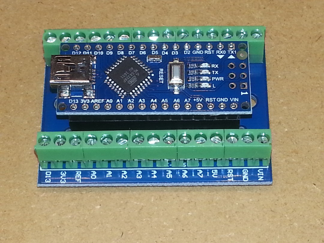

    For some reason I can't get any voltage from the screw shield. The 5v on the shield has voltage but the ground point not grounded unless I touch the Nano ground pin.
    Wiring looks fine and GRBL settings are set as they should. I am using the usb 3 port already.
    I can get all the 3 axis to work in both directions by switching to the Uno so I know for sure that the wiring and settings are good.
    It's just weird and doesn't make sense. I went through 13 Nano already. In which 2 of them can turn all 3-axis in one direction and 1 can turn 2-axis in one direction and the X-axis in both directions.

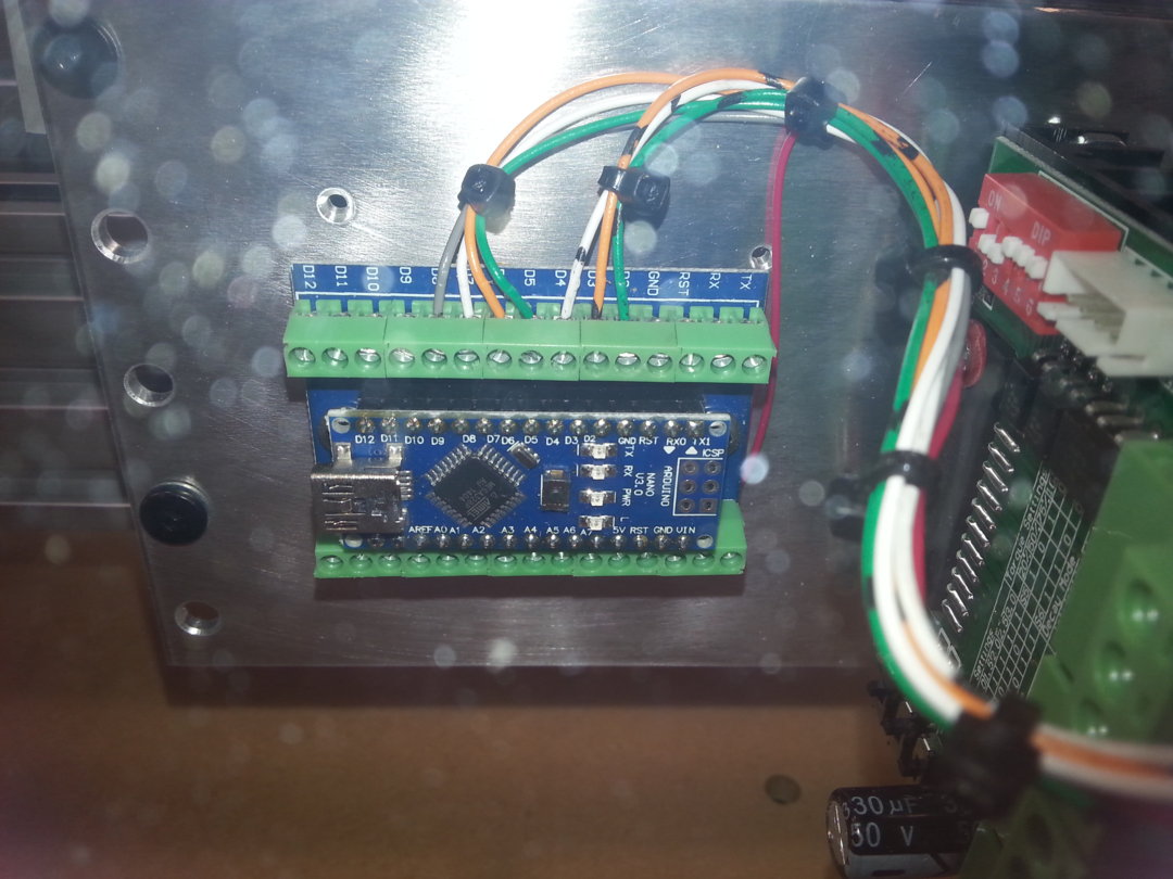

    OK, well that's a clue. Where are you trying to measure your voltage from? What are you using as a ground point? The drivers are isolated from the stepper motor power supply by optical isolators, so you can't use the 24V supply ground as a reference point. You have to use the Nano ground as a reference point.
    There has to be a wiring error. There is no way 13 Nano's are all bad... Have you been using the same shield for all these tests? As Scotty pointed out, the shield may have a problem. The Nanos you are using, did they come with the connector pin strips unsoldered? Did you solder them correctly? Did you check the solder joints on the screw terminal shield? Is the Nano inserted into the shield the right way around? Nano screw shields sometimes have the legend for the pins printed a bit off, are you sure you have the wires connected to the shield board in the right locations? X pulse should be the fifth pin (D2) from the end, y is #6 (D3), Z is #7(D4) etc. I'm just clutching at straws here, none of this makes any sense.
    Comparing this to the Uno is not really a fair comparison since you would have to remove and reconnect all the wires when you changed to the Uno. Does your Uno have a screw terminal shield as well?
    It HAS to be a wiring error. Everything points to this. There is some difference in the wiring between the Uno and the Nano that is causing it not to work. I KNOW Nanos work fine in this application. I have built over 50 machines using them, and never had a problem.

    I triple checked the wires and didn't find any issue with them. I did the solder on the pin strips and I am certain it's not the issue.
    I have finally found what was happening! For some reason most of the shield pins have some really bad/weak conduction. Although they tested okay when checking continuity they were not transmitting signals, at least not as they should. I end up re-soldering all the shield joints and Voila!
    The weird thing is 2 different screw shields from 2 different sellers has the exact same issue!
    Everything works now with both, GRBL and Estlcam settings!

    I follow your suggestion and wire the Nano directly to the driver without the screw shield and it did work flawlessly. It appeared that the screw shields had bad connections. I ended up re-soldering all the screw joints and now everything works like it should!
