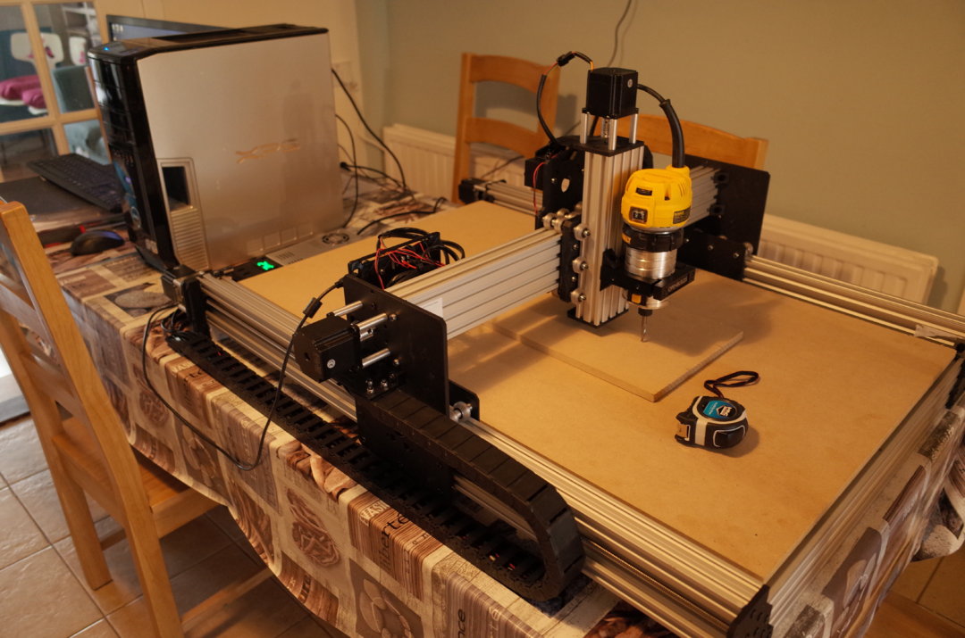

    Hi all,
    Extream newbie with my just finished WorkBee.
    Great Forum, made build a lot easier!
    Best,
    Jim.

    Nice work @Jim..... What will you be making with your CNC?

    Thank you,
    Hoping to get to grips with some simple boat name plaques among other things. We do a lot of local commercial fishing boat reg numbers in vinyl and this would be a nice additional service to offer.

    @Jim..... Thanks for the picture looking good!

  12. Jim.....
    Jim..... New
    Dec 31, 2017
    17
    All,
    I wonder, what is your preferred method of attaching your wasteboard to your Workbee rails? I have used method one from the manual which is the higher setting, any suggestions for me as this is all very new to me.
    Thank you,
    Jim.
  13. Kyle Barrett
    Dec 5, 2017
    28
    my spoiler board is over 18 mm thick. was an inch when I started. I drilled a pocket down about half way and then used a drill to make a small drill hole. I then put a new M5 screw down through the board and used a drop in tee nut to attach. I have one in each corner. I also squared everything up to. Can't wait to start cutting.

  15. Ryan Lock
    Ryan Lock Veteran
    Oct 12, 2014
    530
    295
    You can use M5 Bolts and drop in tee nuts.
    Ryan

  26. T4Concepts
    T4Concepts Journeyman
    Dec 7, 2017
    108
    115
    Nice pic and well done Jim ......... must be real happy with that.
    I just ordered my full WorkBee kit from Ryan at Ooznest just before Christmas, can't wait to get stuck in :D
    Just one question though guys .............. why is it every cnc build I see has the motor/spindle mount so far up the Z axis ? same as Jim has on his assembly.
    When I receive my WorkBee I'll be trying to install the spindle mount right at the end of the Z axis, hopefully that should give me a little more cut depth, or is that not recommended due to stability ?
    BTW, really impressed with your carving of the boat Jim :thumbsup:

  27. Jim.....
    Jim..... New
    Dec 31, 2017
    17
    Turk,
    In the manual it shows two settings to mount the spoiler board. I chose the higher method one setting but I think I may change to the method two so to have a greater Z range.
  28. Awestruck
    Awestruck New
    Dec 17, 2017
    78
    15
    @T4Concepts / TURK -
    Think of the Z axis, include the router/spindle and the bit as a large lever on the gantry. When the Z axis is down, router is low and bit is driving into material, there will be a force on the gantry. So I suspect what you are observing is trying to keep rigidity by mounting the router/spindle a little higher on the extrusion. It is still a level. The key is to be careful that the bit and material height doesn't interfere with the extrusion used on the Z axis.
    Also, just as Jim mentioned too, you can configure the height of the spoiler board when you build your unit.
  29. Ryan Lock
    Ryan Lock Veteran
    Oct 12, 2014
    530
    295
    @T4Concepts The position of the router on the Z-Axis extrusion doesn't really effect the max cutting depth, the max cutting depth is determined by the distance between the underside of the Z-Axis and spoilerboard. Then router needs to be mounted in a position to take advantage of this. For instance if you wanted to cut the full max depth, then you need the router positioned the cutting bit is sticking out below the underside of the Z-Axis the exact cut depth.
    Also the ideal situation, would be to have the material mounted as close to the router as possible, then you are minimizing the cantilever distance when cutting.
    Ryan
