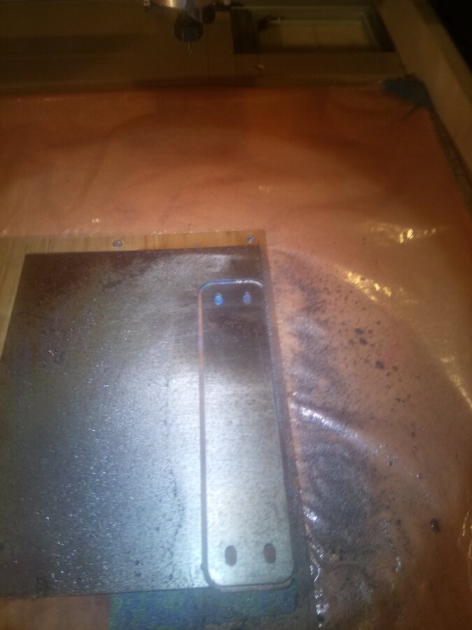

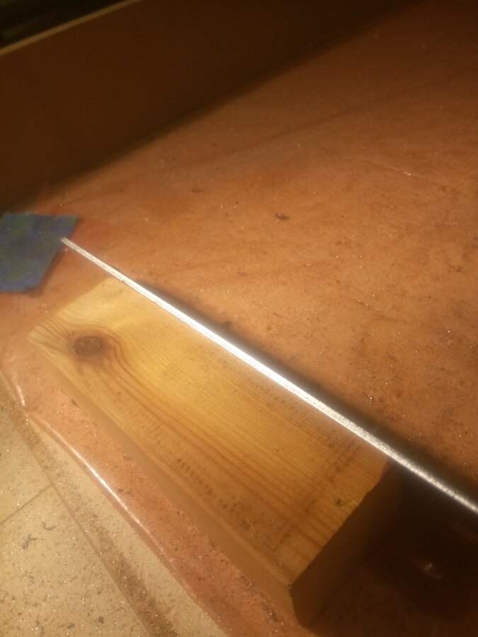

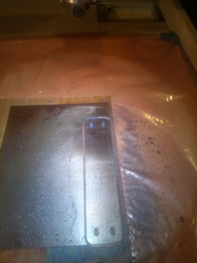

  6. Alex Chambers
    2,834
    1,393
    It's over two years since I started this build report, and I have learned a lot since then - from using the workbee and, not least, the Openbuilds forum. The latest experiment was cutting a replacement arm rest bracket for one of my sons' wheelchairs from mild steel on my un-modified Ooznest workbee - (Chinese clone) Makita @12.5 K rpm, 250 mm/min, 0.1 mm doc. Single flute 3 mm spiral upcut. Blue masking tape and superglue to hold the material.
    I could undoubtedly have gone faster and deeper, but didn't want to push my luck with a first attempt.
    sharmstr and Giarc like this.

  8. Alex Chambers
    2,834
    1,393
    I was a bit nervous about this, hence the cautious feeds and speeds, but the result is way better than anything I've achieved with aluminium.
