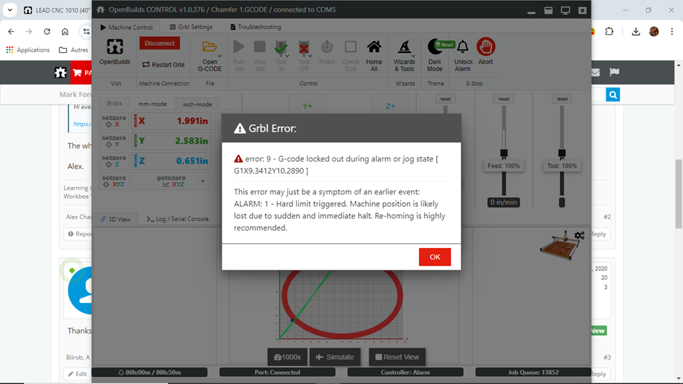

    Here is something new for me. I get this error code 9 This is the screen shot. Any ideas? upload_2024-10-7_12-26-27.png
  5. Alex Chambers
    2,797
    1,377
    The error message says that you triggered a limit switch, either by running into it or accidentally touching it.

    Hi guys, new error message this morning not the same as last time. Is it still the same problem?
  8. Peter Van Der Walt
    15,191
    4,346
    Same, false limit trigger, likely EMI, see above

    Hi Peter, I separated the wiring of my router and the motors, I still get this error.
    #10 Bilrob, Oct 15, 2024
  11. Peter Van Der Walt
    15,191
    4,346
    Thats just one suggestion, read the full article and apply all the tips
    Or disable Hard Limits (Use Soft Limits instead) - but then the still present EMI source might affect the next thing (serial corruption probably next)
    Always best to fix where the EMI is coming from...
