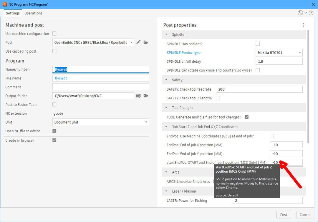

    Working on getting my machine set up and running and seem to be running into a problem in the beginning of every job.
    I’m using JS CNC with fusion 360 and the open builds grbl post processor.
    I have a 1000x1000 v-slot type machine with an xpro v5 and a huanyang spindle.
    I have my hope set 2.5mm off each home switch and set my work zero on the front, top, left corner of my workpiece which is pretty standard.
    The problem is evey time I run a job it will start up fine but then raise up in Z until hitting the limit switch, alarm, and stop.
    I’ve been able to mess with some of the initial lines in the code to get it to run after a lot of trial and error (G53 z-10) I think is what finally got it to work. But I want to understand exactly why this is happening and what I should be doing differently.
    Gcode and sample nc file here, also some screenshots I get when posting and settings from the post.

  2. sharmstr
    2,059
    1,449
    G53 Z-10 is a clearance move. It will move to 10mm below your z limit switch. Then move to the first position.
    By the looks of the log it doesnt look like you are re-homing your machine after the reset. If you've correctly homed your machine, then set your work zeros, it should work.
    The message you're getting from Fusion is just a warning that you havent selected a WCS in your setup so its going to default to G54. If you want to avoid that message in the future, go into any setup, set WCS to 1, right click and select save as default. Then any new setup will automatically be set to 1 which is G54.
  3. David the swarfer
    3,490
    1,927
    The post processor options allow you to set the Z clearance, which it will then use for the G53 safety move. If you are getting a G53 G0 Z0 move (will always alarm) then it means YOU changed the default value, so you should know where to change it back (-:
    The G53 safety moves rely on proper homing to function correctly.
    Please read this Home, Fusion360 and G53 Z moves
    (there has to be a clearance value because GRBL, the software in the controller, requires it.
    Moving to the axis 0 will always trigger the limit switch and cause an alarm).

  6. David the swarfer
    3,490
    1,927
    no.
    you do need to rehome after any errors or alarms, USB reconnect, or power cycle.
    It will use WCS G54 (the default) and will not warn you about it not being set.
    The critical thing is to set the Z home offset in Fusion360's post options to -something, where the something is enough to avoid hitting the limit switch. if 1mm is enough, then use -1, if you need more, then use that value.
    I am not at my Fusion computer now otherwise I would send a screenshot

  8. David the swarfer
    3,490
    1,927
    ok, so the G53 G0 Z-10 is hitting the limit switch at the top of Z travel?
    lets just make sure we have the basics....
    • Z positive tool travel is 'away from the work'
    • negative travel is 'toward the work'
    • Z home is at the positive end, safely UP and away from the work
    thus if the top of the work is set as WCS z=0 all retract, non cutting moves will be at positive Z levels and all cutting will be at negative Z levels. This is indeed the case in your file, the first move of the facing operation is to plunge down to about -7mm.
    your settings indicate
    Code:
    $27=2.500 (Homing switch pull-off distance, millimeters)
    and you said
    the 2.5mm does not affect where home is, it is a pulloff distance to clear the switch. GRBL cannot handle it if an axis goes to 0 and hits a switch, that is a hard limit error. This allow one to have a switch at both ends of travel to stop the machine crashing into itself.
    If 2.5mm is a reliable pulloff, you can use that in the post settings so your code gets
    G53 G0 Z-2.5
    to reliably raise Z to safe height before the first positioning move.
    however, there is something else set incorrectly if
    G53 G0 Z-10
    actually hits the limit switch.
  9. David the swarfer
    3,490
    1,927
    oh! you edited your post! please use the unaltered OB post and lets see what the machine does. once that is all correct you can alter the post if you need to , but NOT to fix machine setup issues, please (-:

    Here is the Fusion post options dialog
    The Z start and end offset setting is arrowed

    In the OB post, there is a hold off distance that defaults to -10mm, so the start and end code becomes
    G53 G0 Z-10
    which raises the Z safely but avoids hitting the switch by 10mm (always negative, 0 is as high as Z can go).
    10mm is too much for most switches, most will be missed by just 1mm, so you can set it to -1 and test and that will give you the most clearance, safely.
