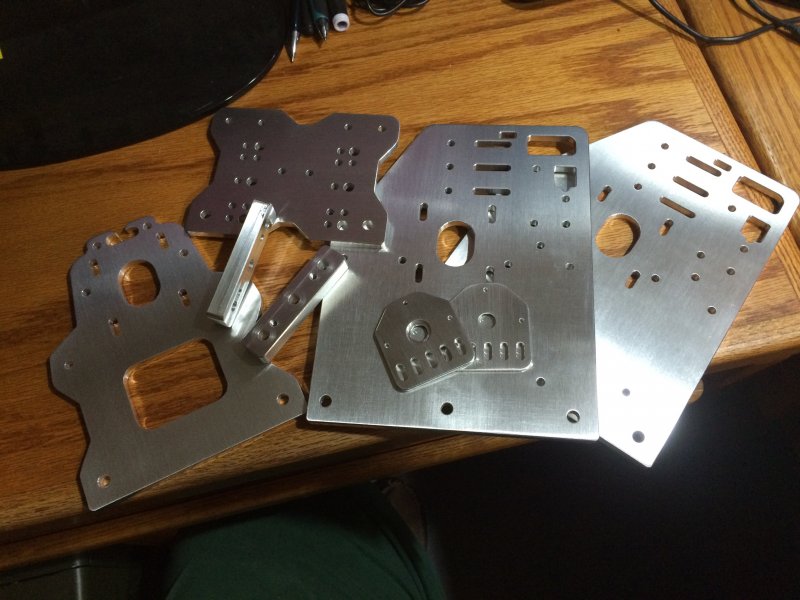

Also ordered the aluminum plates from Chris Laidlaw (Blue Ox Solutions) at his eBay store. Chris does beautiful work and I highly recommend him! Oh! And he's fast on the shipping too!

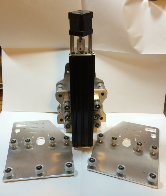

Oct. 21, 2014 first parts show up, Chris plates, of course.

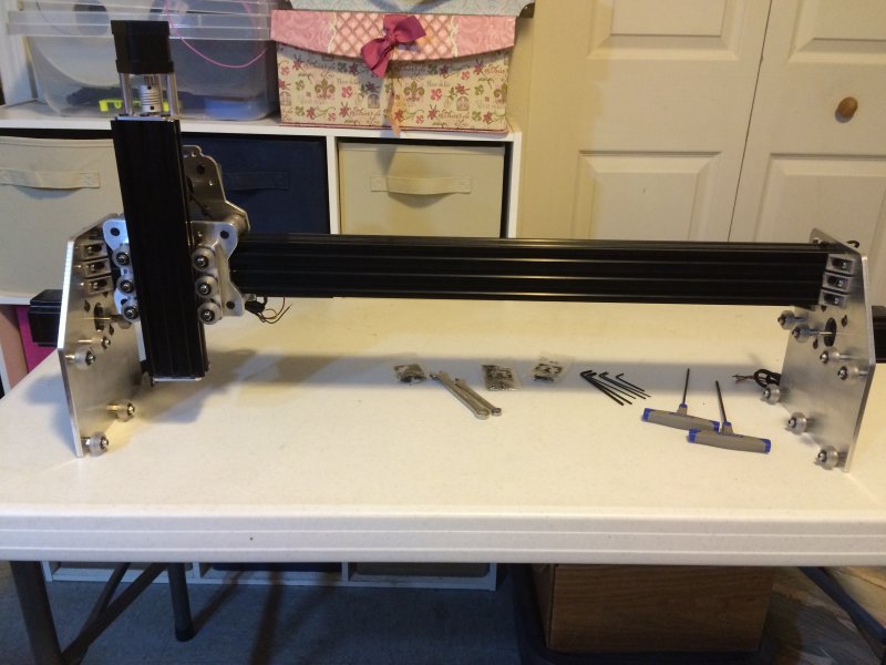

Then a few days later the OpenBuilds parts show up and we started assembly.

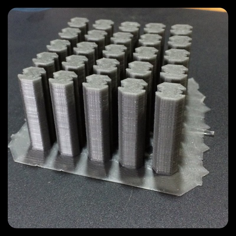

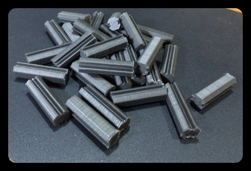

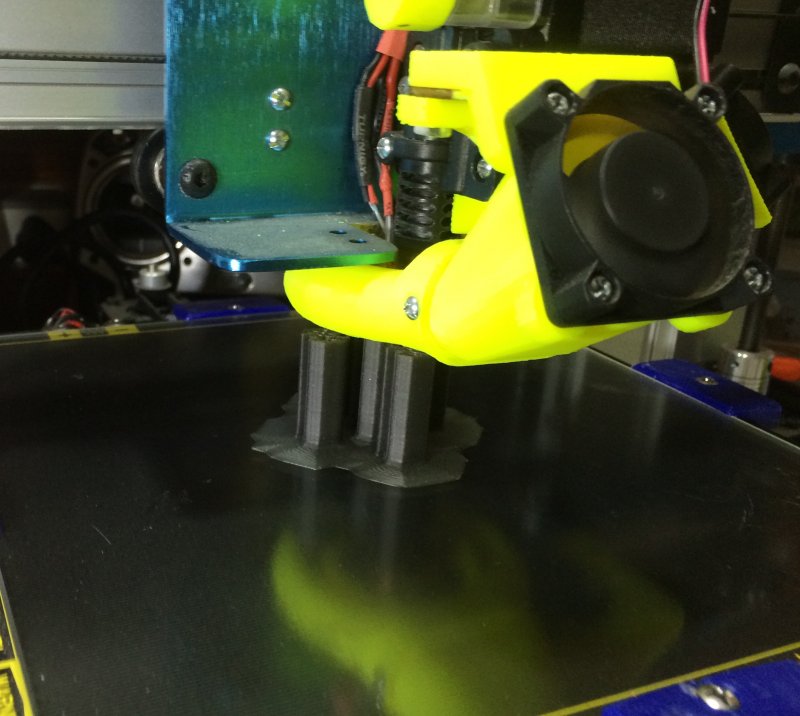

Decided I needed to bond X-axis extrusion together. So out come's the 3D printer and with the file from Openbuils RESOURCES (http://www.openbuilds.com/resources/v-slot-connector.40/) you get thesis and they do a excellent job!

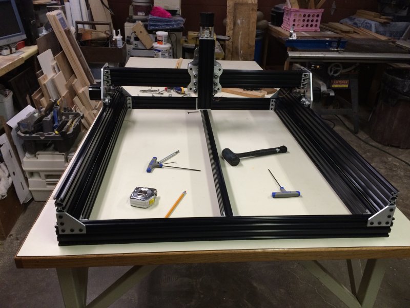

X-axis ready to go.
Now into Nov. and time to move out in the garage.
Most say no way it takes this long to build, I had just had a whole lot of family things going on.

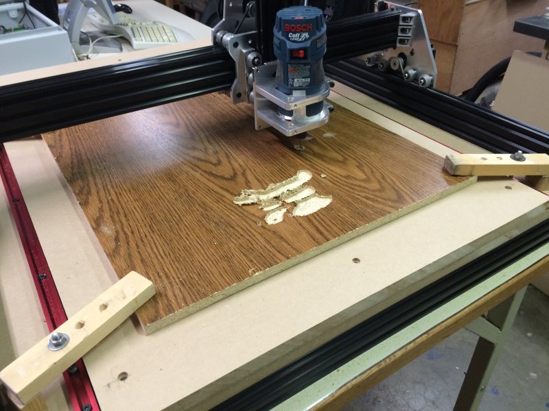

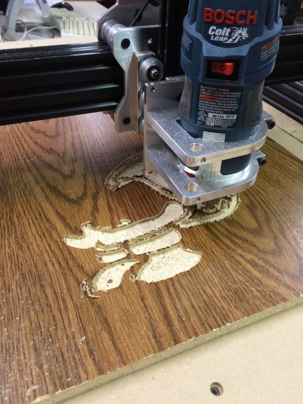

Dec. 18, 2014 Musk-OX come's to life!!
And after a little help form Joy (wife).
