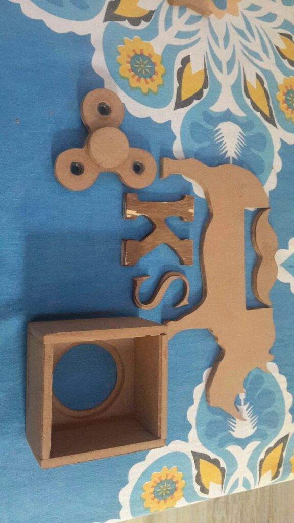

Hey geeks, I was doing test cuts on my home made cnc and the results turned out satisfactory. So today I am sharing my build here.

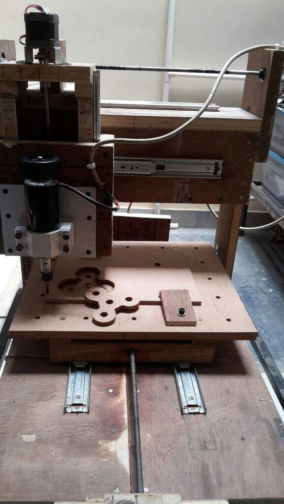

Technical details:
● X-Y table Style.
● Bed size is 280x245mm and 100mm in height.
● I am using 3 nema 17 unipolar stepper motors. (Salvaged from photo copier machine)
● Threaded rod and normal nuts (Added two nuts to handle back lash).
● Drawer Slides for movement.
● Arduino with CNC shield v3.
● Banggood Spindle 3000 to 27000 rpm.
● 4mm 4 flute tool.
Build Details:
I used scrape board left from furniture work. Bed is sandwich of two 7mm MDF sheet. I added T-nuts between two sheets for object holders.
Over all project was built from junk utilisation except spindle, drawer rails and screws.
Result cuts:
My Home made CNC

Home Made CNC Router from Scrape
- Build Complete!
