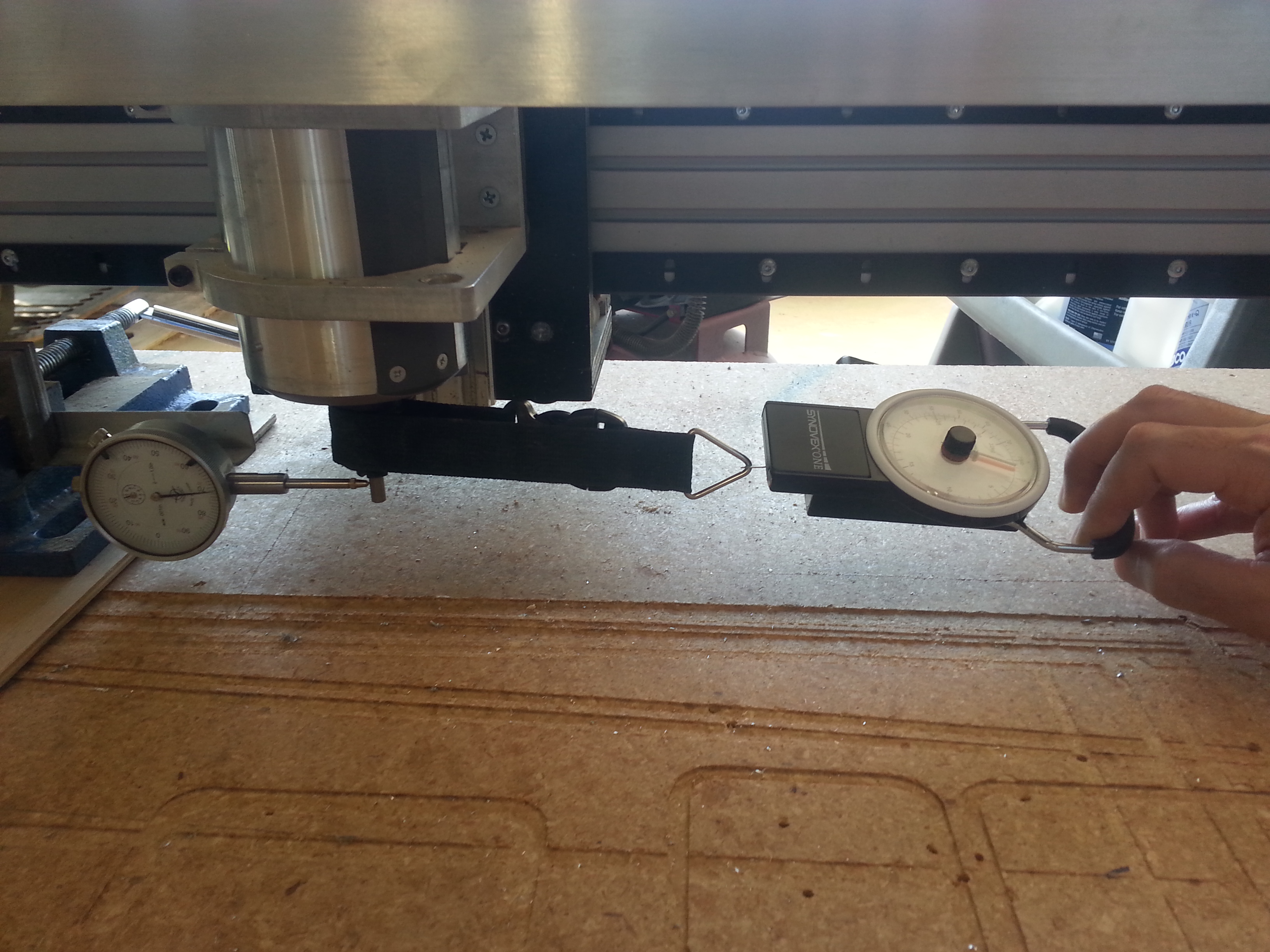

This is the type of test that I do to measure they system deflection under load. I pull on the router chuck with a luggage scale or fish scale and with 5 lb of force applied I measure the deflection with a micrometer as shown. This test is best done in both X and Y directions separately.
