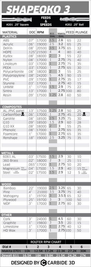

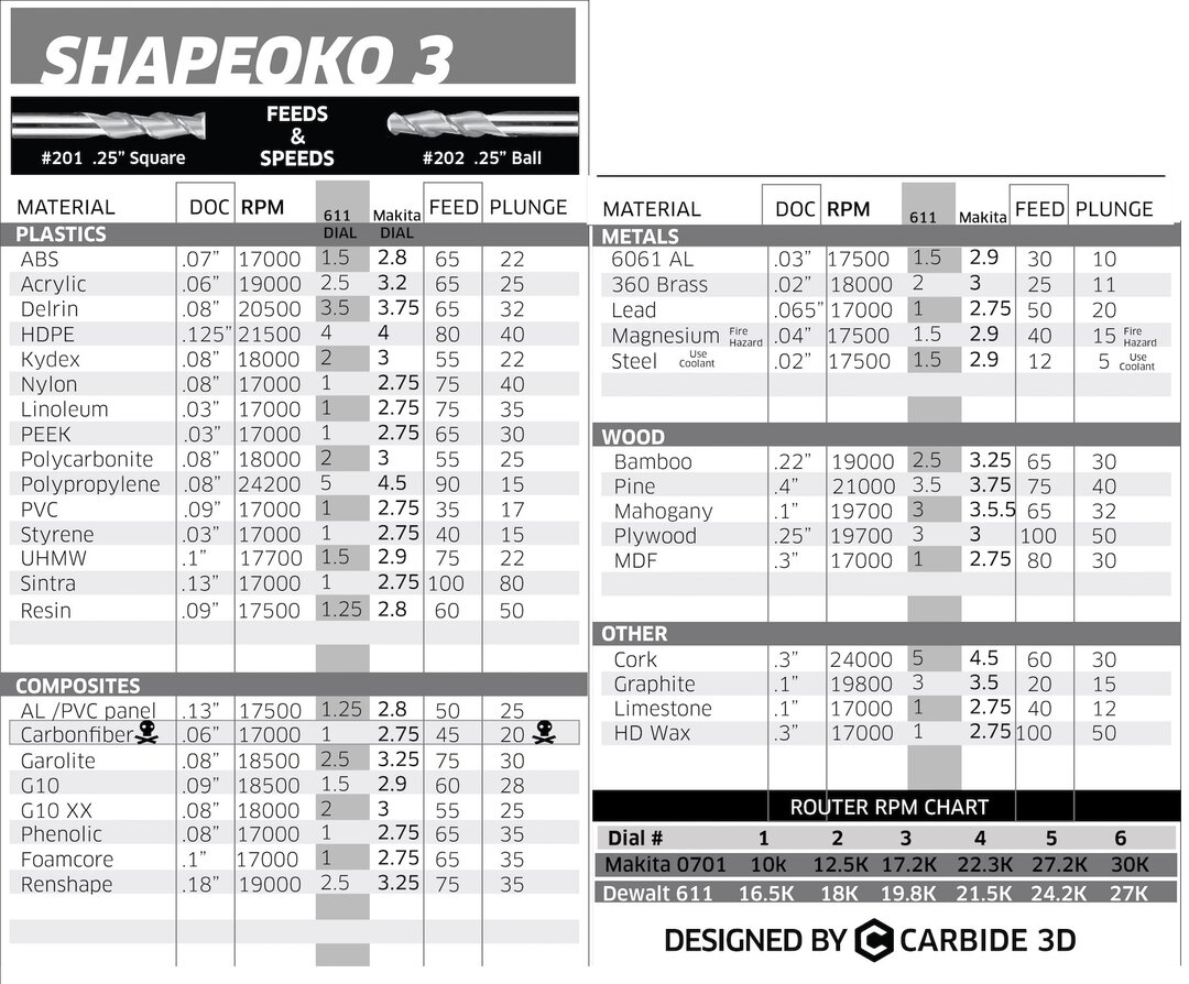

    The guys at Carbide 3D have put together this really handy speeds and feeds chart for hobby level routers.
    This is a great simple to understand chart for speeds and feeds using 1/4" bits.
    This chart has the dial number settings at the bottom for the Dewalt 611 router which is really helpful as well.
    Props go out the the Carbide 3D guys for this share!
    Update: Better format for printing
Recent Updates
  1. Better format for printing

    Wish it included 1/8" End mills as well.

    Great info. Now have to figure out the metric equivalent. :)

    Thanks for this! Now I don't have to guess anymore.

    There is a much clearer version of this on the Carbide 3D site in the FAQ section
