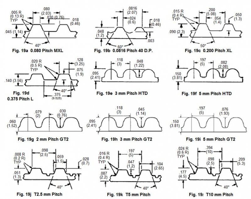

I found this relevant drawing of timing belts on instructables after having to create a solidworks part of the GT3 pully, without having exact measurements.
See the 3rd line, for the GT2 2mm pitch and the GT2 3mm pitch (aka GT3).
Timing Belts 2014-11-13
Different timing belt drawings and measurements
