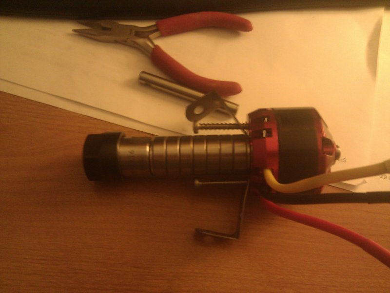

    Hey dudes,
    So I am getting ready to make all this and wanted to run it by you all to make sure it will work. I've got a double-fluted solid carbide bit with 1/4" diameter(6.35mm), some aluminium from the recycling centre (plate=12mm or 1/2" and block=37mm or 1.5"), and my spindle is mounted very cheaply with some bearings, hose clamps, and a steel plate at the top. I plan to use foam to test it and then maybe some wood and then finally this aluminum.

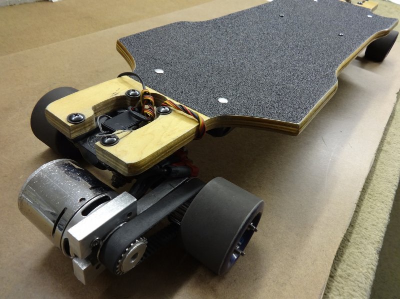

    Iv worked with brushless motors for over a year for "non-RC" applications. This homemade electric longboard is what introduced me to DIY side of life :D I weight 150lbs and can get 27mph out of this little motor (25.2volts and 200A ESC), don't underestimate these little buggers, they'll nock your teeth out.

    dang this aluminium is tough to mill. I had the feedrate way down to 100mm/min and it chattered the machine to the point of slipping steps and flexing the gantry. I believe 5ipm=127mm/min... so maybe I can try again at 20mm/min but now the v-slot wheels on one part have a little play that can't be taken up by the eccentric spacers... Does this mean the wheel is hosed or the hole is off or the screw is bent or what?

    A lot has to do with the bit, also the way your spindle is mounted.
    Not knocking ya in any way I feel you jumped into aluminum a little to quick.
    Where and how are the esentrics installed "plate? V-grove channel?"
    Odds of the bolt bending are low
  17. Rick 2.0
    2,912
    1,578

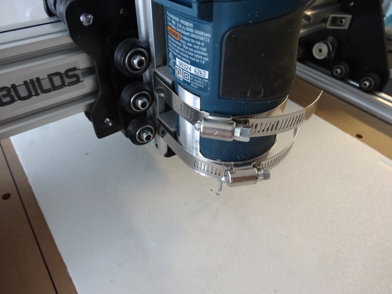

    If the spindle is bucking in any, the bit will bounce rather than bite. You shouldn't be having to push anywhere near as hard as you are. Maybe it's time to rethink the mount.
    Have you successfully done any plunge cuts with the bit? (assuming it is plunge capable)
  18. The Dude
    The Dude Well-Known
    Jan 2, 2014
    243
    103
    I cut some pine with ease and it came out clean and smooth. Go too fast and it chatters. I guess the bit was bouncing like you said. I don't have any other way to mount it except like Robert did with the angle bracket and no bearings but I was trying not to burn out the bearings on the motor. Sigh, guess I can remount it...
  19. Rick 2.0
    2,912
    1,578
    Consider cutting a V-shaped notch in a couple blocks of wood and wedging them behind it. Cinch it down into the notch and that will give you a good grip with minimal contact so you can still easily dissipate heat.

    Any material is probably fine, the main goal is just to get it wedged into something with a wider spread to stabilize it. Notice how Mark has the spindle wedged and tightened into a V-shaped support on the OX build.
    Photo credit kram242
    It's mainly your lower mount that appears suspect, but it wouldn't hurt to apply the same principle to both. Once it's solid, you still have to deal with the play in the wheels.... Sorry, no suggestions there.
