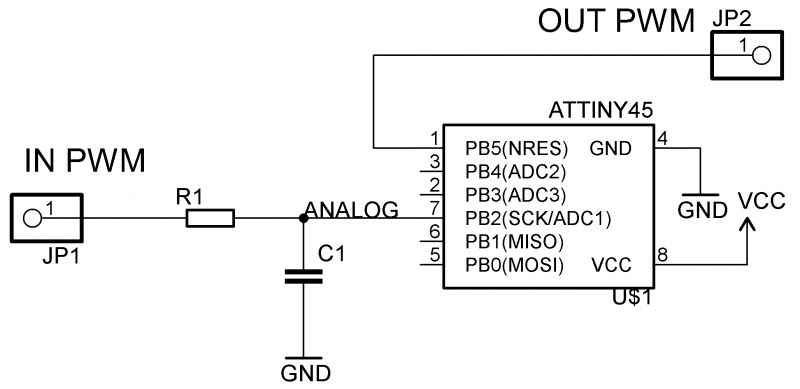

  14. oni305
    oni305 Well-Known
    Jan 16, 2014
    106
    85
    I havent Mach3 (nor a cnc yet :p) but i think it not to difficult to create a little board to generate the PWM
    something like this
    it can also function as a servo tester relacing the RC filter whit a pontetimeter
  15. Robert Hummel
    Robert Hummel Custom Builder
    Moderator
    Nov 14, 2013
    978
    717
    Sweet!
    I will try and design a pcb :)

  17. oni305
    oni305 Well-Known
    Jan 16, 2014
    106
    85
    No, i haven't any code...(yet) i'have design that schematics with a "random" attiny only for the concept..
    This schematics trasform a pwm to an analog tension 0-5v, read the value and generate a new pwm
    If you give me some specification of the output which mach3 gave, i can design a more accurate circuit!
  18. Tweakie
    Tweakie OpenBuilds Team
    Moderator
    Jan 18, 2014
    784
    326
    Just thinking out loud...
    The Mach3 PWM output will have an amplitude that matches the TTL standard used by the parallel port - some will be to the older 5 Volt standard and the newer parallel ports will be to the 3.3 Volt standard.
    This may add a slight complication to the analog sampling method if a PWM driven speed controller is to be universal between different PC's.
    Not an obstacle that can't be easily overcome but you may want to take it into consideration at this stage. ;)
    Tweakie.

    oni305 Well-Known
    Jan 16, 2014
    106
    85
    Not really...
    An Optocoupler is enough to overcome this (moreover, it is always a good idea to isolate the PC from external electronics)
    The only problem I see is to know the frequency of the PWM signal generated on the LPT to tune the RC filter, after that everything could be done via software
  25. Tweakie
    Moderator
    Jan 18, 2014
    784
    326
    When running Mach3 with a Kernel speed of 25kHz you can choose (more or less) any pulse repetition frequency for the PWM signal of between 5 Hz and 4 kHz.
    Tweakie.
