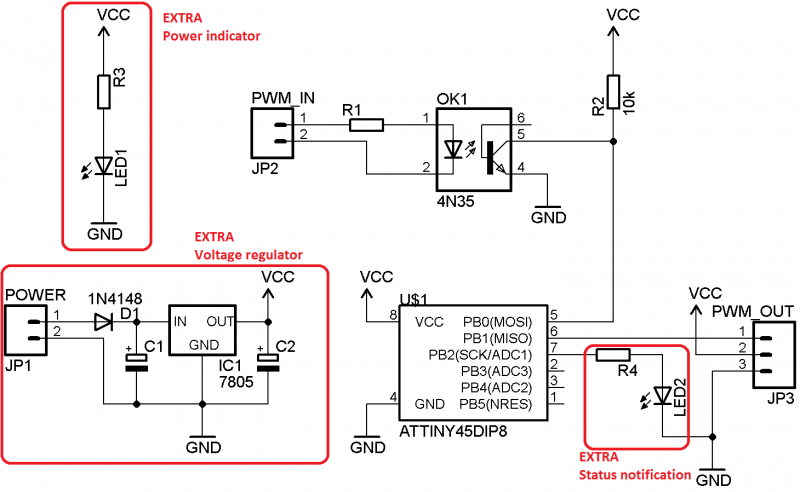

  15. oni305
    oni305 Well-Known
    Jan 16, 2014
    106
    85
    I think the circuit could be something like this

  16. Robert Hummel
    Robert Hummel Custom Builder
    Moderator
    Nov 14, 2013
    978
    716
    I
    have all said parts needed to construct the circuit shown mind you it's a 85 not 45 but that really don't matter other then cost
  17. oni305
    oni305 Well-Known
    Jan 16, 2014
    106
    85
    :p it's the same chip (only the amount of memory change ) and in the cad one symbol is enough to make the design
  18. Robert Hummel
    Moderator
    Nov 14, 2013
    978
    716
    Do you think a PC817 would also work in place of the 4n35, may not be fast enough :/
  19. oni305
    oni305 Well-Known
    Jan 16, 2014
    106
    85
    If the max freq is 4 Khz (as tweakie said) the pc817 can be used, but R2 have to be a 1K
