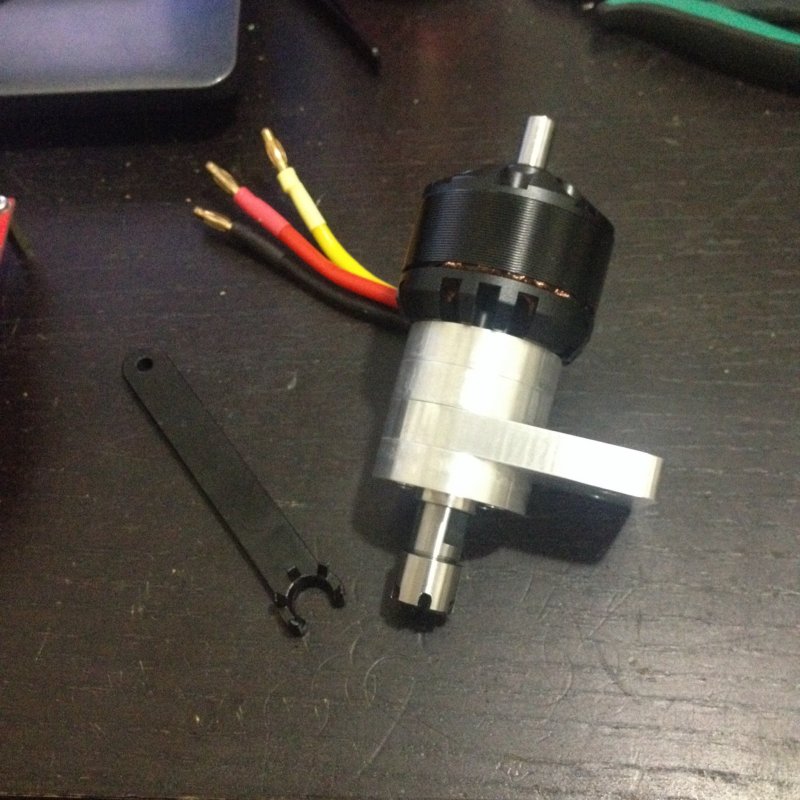

  13. Robert Hummel
    Robert Hummel Custom Builder
    Moderator
    Nov 14, 2013
    978
    717
    Parts are in so I gotta get this done lol
    Went with a different type of collet, ER11M instead of the reg ER11A
    Now where's the coffee pot?
  14. Robert Hummel
    Moderator
    Nov 14, 2013
    978
    717
    The diff is the way it locks and it's lighter.
    It comes with a special locking wrench :)
  15. Robert Hummel
    Moderator
    Nov 14, 2013
    978
    717
    And here it is :)
    Picking up the m4 screws tomorrow and then it's testing time ;)

  16. Rick 2.0
    2,912
    1,579
    That was quick. What motor are you running and what rpms are you anticipating?
  17. Robert Hummel
    Moderator
    Nov 14, 2013
    978
    717
    It is 890kv as all my others, it's the sweet spot @12-14 vdc IMO
    RPM max no load will be around 10,000.
    This one is a little different as it's going on the Stinger PCB mill ;)
