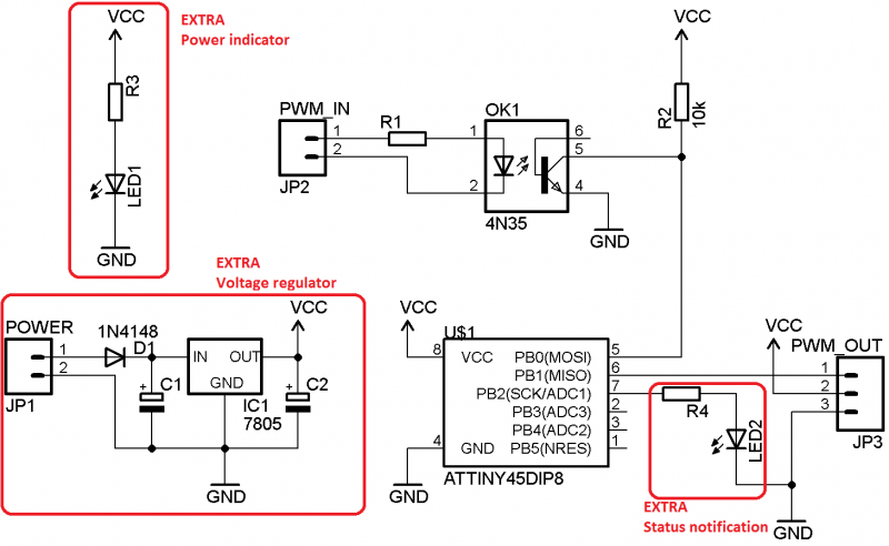

    I've been investigating using a smoothie controller board for a future build. Since it has a few pwm outputs available it "should" be able to control the ESC. Is this the circuit I need to build to control the brushless motor? I read this thread start to finish again and it seems like there were some jumps from here to the end.

  12. Nick W
    Nick W Well-Known
    Oct 22, 2014
    99
    61
    Ah yeah. That's the part that puts a wrench into the works. I knew there was something I missed.

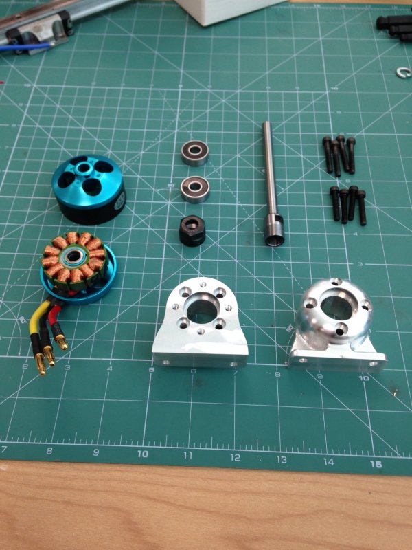

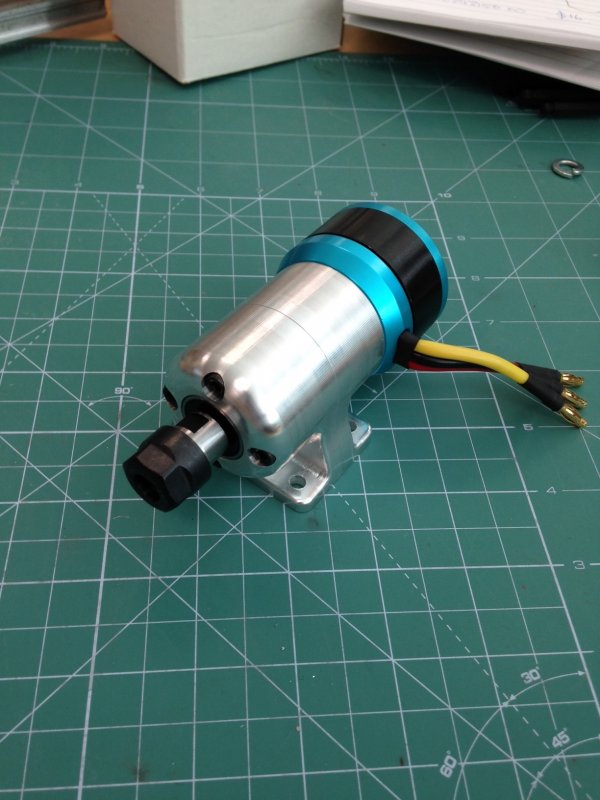

    Hey Guys,
    I decided to give this a go, fortunately I have access to a full size CNC mill so modified the design slightly. I haven't had a chance to test the spindle out yet but have a 60A brushless ESC and servo tester which should do the trick.
    Pics Below:
    I did have one question though, I had planned to mount the ESC to my Z axis V-slot and have power cables running all the way to my power supply. I was reading up on some RC aircraft stuff and they recommend adding a pair of capacitors across the power cables for each 10cm of added power cable! Did any of you bother with that? I did notice my ESC already has a pair of caps but the info I read advised adding more.
    Cheers
    J

  14. Robert Hummel
    Robert Hummel Custom Builder
    Moderator
    Nov 14, 2013
    978
    717
    Love it and wish I had the means to make a beautiful housing like that :)
    I would go with 608zz bearings as they are rated for the RPMs you will be pushing.
    I just picked up some flanged 608z for a rebuild :)
    Great work I'm sure it will work awesome
    As for the esc I mounted it in my controller to keep the pwm wires short.
    I then used sheilded power supply cable like they use in hospital grade plugs for the 3 winding wires.
    It was 12 feet long and I had no issues :)
    Keep in mind this is not a RC condition so your not running off a depleting battery ;)

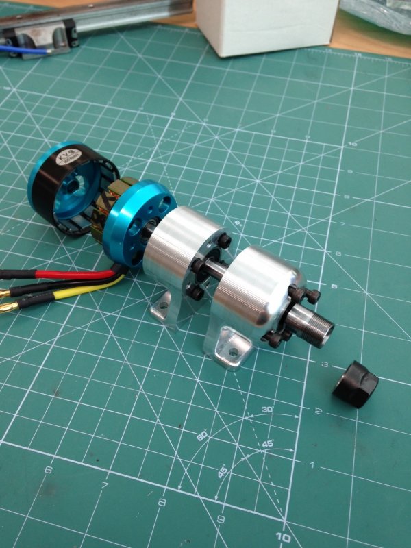

    Hi Everyone,
    @Shinohara expressed an interest in using my model to machine a spindle for himself, so I have exported the models as .STP files and attached them. Obviously you will need access to a CNC mill but feel free to use these models to machine your own.
    A couple of things to consider:
    - These housings are designed to fit 608 2RS bearings (same as 608ZZ, but with rubber instead of metal shields) so the holes are modeled as 22 mm diameter. I altered my CAM sequence to take an extra 0.01 mm of material off to get a perfect push fit on the bearings (22.02 mm overall diameter). I often model on the safe side and perform this "on machine" adjustment as I am machining to get the perfect fit on critical parts.
    - Be sure to assemble the housing and motor using the shaft to align all the components.
    - When mounting to the Z-axis v-slot, the clearance to insert and tighten the mounting screws (10 mm allen cap screws) is quite tight and you'll need to use a ball ended allen key to tighten them, alternatively you could use hex head bolts.
    Cheers,
