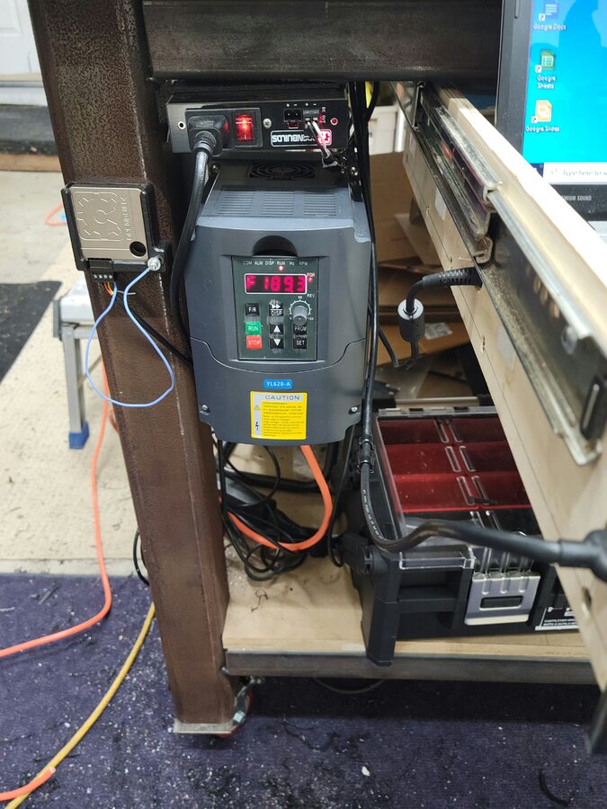

    I decided to swap out the Dewalt for 1.5kw spindle and VFD. The change over was pretty painless, I just had to make a mounting plate to attach the spindle to the Z gantry. I used a piece of 1/4" aluminum as my mounting plate.
    I'm just going to use the VFD to turn it on/off and adjust the speed for now.
    I will run a few things tomorrow to see how it does. So far, it's much quieter. 20211112_161615.jpg 20211112_192912.jpg 20211112_193338.jpg

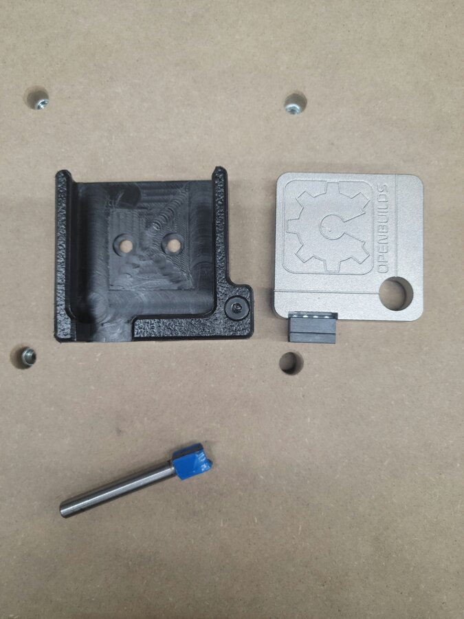

    161
    That's a sweet looking probe holder.

    Thanks, I used a 3D printed one I saw here as inspiration and machined it out of HDPE 20211010_195255.jpg

    Sorry I was trying to be funny... I posted that probe holder file to the recourse page.

    Nice job machining that out of HDPE!

    Oooops! I missed that, so sorry! Still good if anyone else stumbles on it in this thread, now its linked to your awesome holder again :)
    You know I genuinely think its a good design if I even recommend it to its original creator lol!

    Sorry, I didn't realize the 3D Printed one was from you. Thanks for the original design.

    I'm impressed after the initial test. The spindle is much quieter than the Dewalt and seems to have a lot more torque....we will see how well it performs over time with some production work under it's belt.
    I got lucky with the tram....it's only out a couple thousands of an inch in all directions.....close enough for me, for now.
    With this unit, I didn't have to mess with any of the programming. It doesn't come with any wiring so I purchased a 50' 16gauge extension cord. I cut the plug end off with about 6' for the power supply and used what I needed to run from the VFD to the spindle. After wiring it up, it's running right out of the box.
