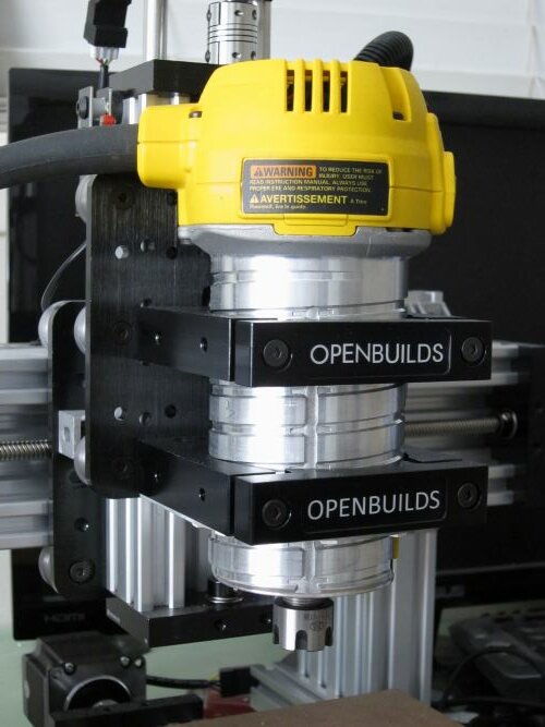

    LEAD CNC + DeWalt 611 router. The spindle mount is thin and not very sturdy -- there is not a lot of vertical support between the mount and the gantry plate, and the router wobbles within the mount. On contact with material, the router kicks itself to the side, like a badly trammed spindle. Cuts are not straight, especially on entry and exit.
    Also having trouble with tramming, especially when surfacing. Even something as trivial as adjusting the dust shoe throws off the tram.
    Any solutions? Are there thicker mounts out there with more support?
    Tramming mounts that fit the C-beam gantry plate?
  2. Rick 2.0
    2,912
    1,575
    Easiest solution is just to add another mount bracket.
    Shy of doing that though, keeping the extension distance of the router below the mount to a minimum (1" at most) helps. You might also try leaving the router's locking ring in place, tightened tightly down to the top of the mount to help stabilize the router.

    A single router mount should be more than sufficient, what you are describing sounds like something wrong. Are you sure the front plate is tight? Didn't perhaps use screws slightly too long that bottom out in the hole before pulling the front plate tight?

    Should not happen, thus my suspicion that
    Indicates the screws are bottoming out in the threaded holes, before you have a grip on the router. It doesn't take much to hold the router tight - take the router out, see where the screws bottom out. Can always shorten them a bit
    Indeed, but - there is an argument to the fact that 99.9% of users do not fit a second mount. Something is loose. Find that first. If it was by design flaky, you'd know we'd have changed it, or you'd see double mounts on all the Builds on the Builds tab (;
    Keep in mind the mount is perfectly perpendicular to the Z axis already in one direction (perfecly milled edge, tight against plate), and slight adjustment side to side by way of oversided screw holes - if you are off - the tramming is almost always in the frame (as mentioned above) - fixing it by shimming the router mount to correct, does nothing to address (for example) a tilted Z axis itself, caused by mounting one side of the gantry a bit too high or low compared to the other side. You direction of motion is still off angle, despite shimming the mount. Look at the dependency stack, and its more likely somewhere else than router mount itself if you do have tramming issues.
    That said, your symptoms are not tramming related. A single mount should hold the router just fine. I think your bolts holding the front plate on is a bit long and bottoming out before they have a grip on the router.
