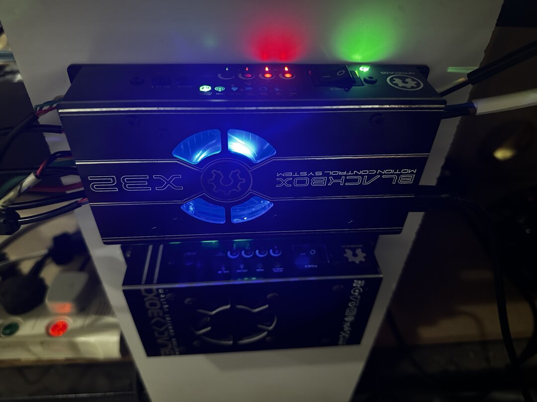

    No i dont mean time. I mean 1) using docs:blackbox-x32:currentadjustment [OpenBuilds Documentation] to add a little (very little at a time) current to the combination of two motors. Together they do need a little more power. But adjusted carefully to avoid overheating. And (2) i mean i dont know where you have your BlackBox but people put them in all kinds of enclosures, drawers, etc so when I say check that airflow is not obstructed i mean is it able to get fresh cool air for the fan to move over the heatsinks to avoid overheating driver than leads to red fault led

    BB box is out side of the table hanging vertically on MDF board ( BB body is cool ) image.jpg

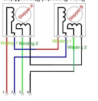

    when I was looking into moving my OX from dual Y drivers to single driver runnign both motors I found a number of web pages advising connecting the motors in series. not parallel.
    I did that and it works perfectly.
    in parallel the motors get the full voltage but half the current
    in series the motors get half the voltage but full current.
    worth a try since these motors appear to want more current
    Mohamma393 likes this.

    Read docs:blackbox-x32:faq-identify-motor-coils [OpenBuilds Documentation] to understand the inner workings a little better, and then view that in context of
    If you want to give it a try
    Mohamma393 and David the swarfer like this.

    I tried but every one moving opposite than other
    Because I’m not smart in electronics Tried again with simpler method **photo below* IMG_4100.jpeg same result
    not sure i did wrong or this one for belt driven machines
    but i think will work after fix , I heard that strong sound when motors start holding
    will google it I think I’m close
  23. Peter Van Der Walt
    Builder Resident Builder
    15,699
    4,509
    swop pins 1 and 2 of one motor only

    Now it moves up to 2100 with not comfortable sound and little vibration, 2500 loss steps
    (I tried with BBx4 at max current , i don’t think 32 will do better as the driver lighting red some times )
    Much batter than parallel which impossible to move 1mm if exceed ~1700mm/m
    But feel on 1200mm/m in parallel is more quite
    thank you for help i really appreciate
