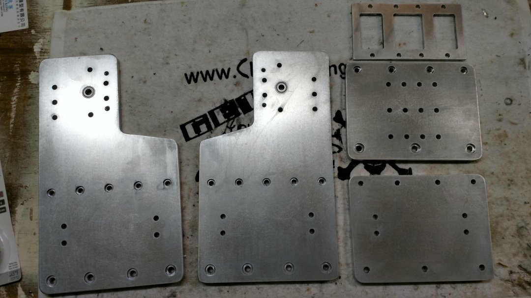

  5. Gary Monroe
    Dec 24, 2016
    67
    21
    My freshly machined plates came this week. Dan did a perfect job, Thank you Dan. Thank you Sonny for hooking me up with Dan to machine them for me. They're perfect! I already inserted the bearings for the 8MM Lead screws. They fit perfectly! Nice job Dan! I'm quite excited to start putting this thing together. My life right now is quite busy, so it will be a while, unfortunately. More to come. Machined Plates.jpg
    #65 Gary Monroe, Jul 27, 2017
  6. Sonny Lowe
    Sonny Lowe Journeyman
    Nov 11, 2015
    143
    158
    Very nice, I must agree, Dan does great work!!! So glad I could help, even if only in a small way :)
