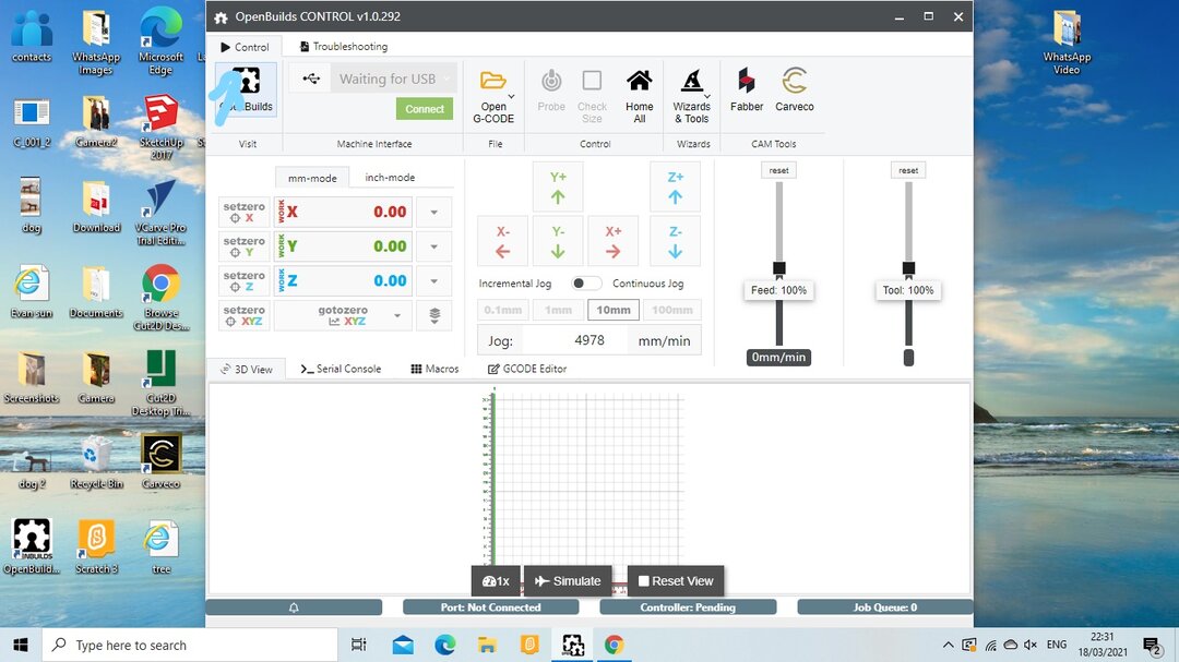

    Latest version of control software (1) when I try to calibrate the x axes and set it to move it 100m it keeps going till it hits the y axes
    The y calibrate works fine
    (2) the openbuild link does not work
    Can you look into it
    Don't get me wrong I love the software
    Thanks joe

    I just tested it with the latest .292 and it works fine. Make sure you're X steps/mm isnt way out of whack. It should be fairly close before using the wizard. Go into grbl settings and set the default starting point for your machine or use the calculator to set it. Save, reset, then try the wizard again.
    If you are talking about the link provided in the software section, it works fine for me: OpenBuilds Software - FREE Software for CNC Control: OpenBuilds CONTROL and OpenBuilds CAM

    Will try the steps tomorrow but no luck with the openbuild link in the earlier versions it always worked I will reinstall again and try thanks joe

    Which link are you referring to? (screenshot please)

    Hope you can Screenshot (1)_LI.jpg see this

    Bug confirmed, will be fixed in 1.0.294

    v1.0.294 is out
