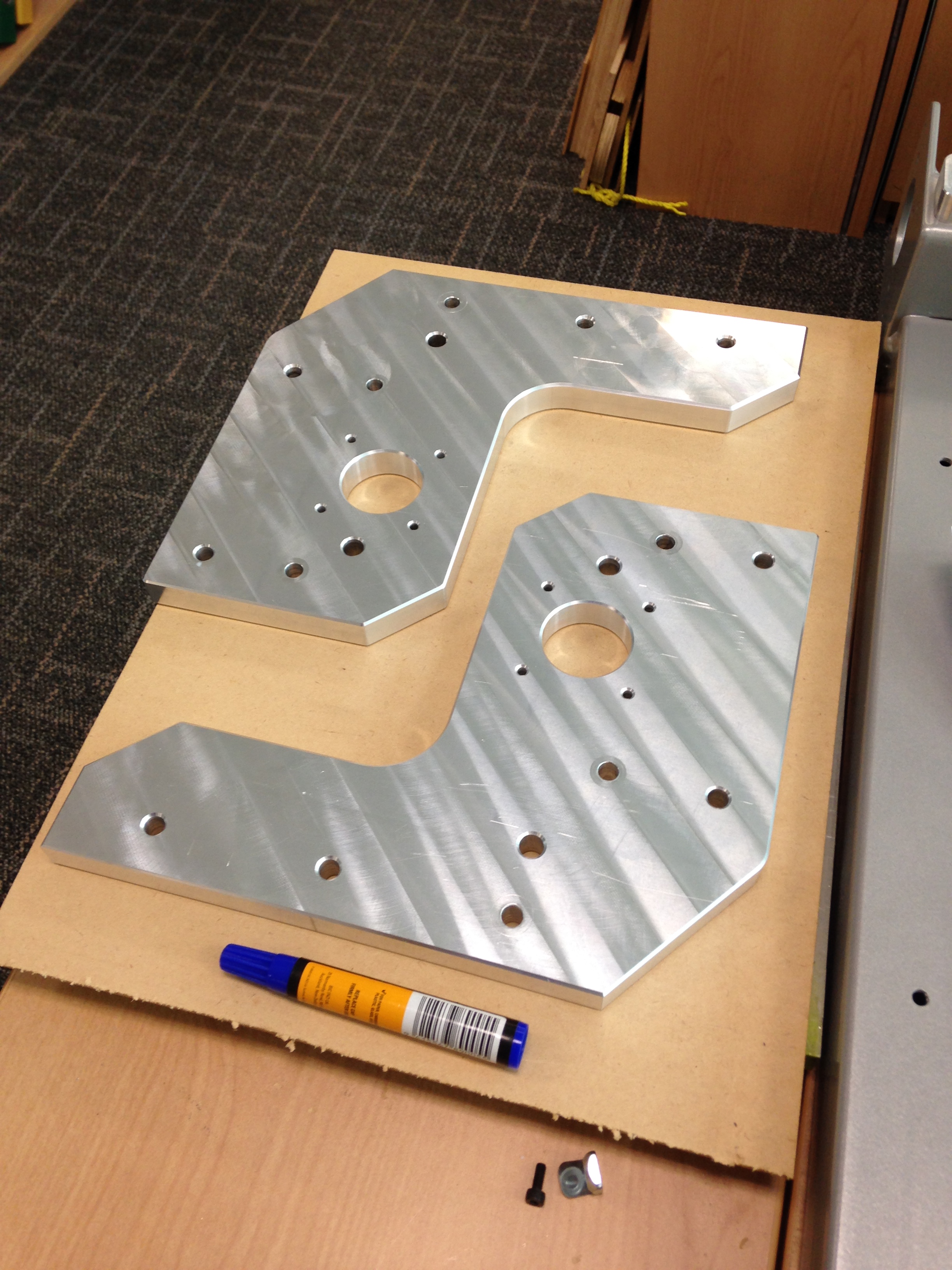

    Thanks can help me. I am wanting to cut some pieces in aluminum with my CNC router. I have always cut wood and I have no idea which carbide end mill to buy to cut aluminum. The parts I want to make in 3/4 "and 1/2" aluminum, what model of carbide end mill should I buy? and what speed should be used for cutting and advancing by pass not to force the Endmill cutter?
    The parts I want to cut are similar to these:

    What size are the smallest holes you need cut? Where are you located? It is hard to provide information on where to purchase (other than from China) without a country listed in your profile. I have purchased from many sources with good luck, but they may not be feasible for you if there are importation costs.

    Although what Giarc said is very correct, it doesn't matter if we don't even know what your machine is. I can give you my settings, but that may destroy your machine, or may not make use of it.
    To make parts like those, you could use as many as seven different tools. 3 drills, 1 face, 1 chamfer, 1 rough, 1 finish
    You can interpolate holes as well, but drilling has given me more accurate and better overall results.
