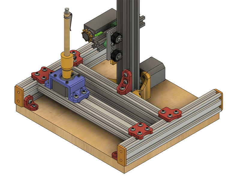

    Think I solved the blind corner space problem. I came up with a custom 3d printed bracket for connecting all the 2040x250mm base extrusions together. I don't have an extra 2040x250mm but do have a 2 - 2020x250mm which this bracket will also connect those together nicely. I printed one & seems as solid as the blind corners, so will print 3 more of them. It does take 5 M5x12mm screws & T-Nuts for each bracket. This is probably a little less expensive also. Should also be easier to adjust the offset of the turntable mounted 2040. Here is what the new model looks like.

    I put it all together today after scavenging the necessary T-Nuts from previous build. I seem to never have enough of those T-Nuts. I used blind corners on the main 2040 beam since I didn't have enough T-nuts, but I do like these custom 3d printed brackets better. I created a 3d printed corner for mounting to the Base board. Having all these V-Slot connections 3d printed keeps the M5 simpler since I design them all to use M5x12mm screws. I also relocated the 3d printed brackets to opposite side of the other 2040 since they interfered with getting the turntable lined up with laser, but later realized that the cantilever arm was not centered on that main beam, so I shifted it to center & rotated those special brackets around. Think I have the BOM together & will work on getting all the STL & assembly file together to upload. This design has come together nicely in a short time.
    Here is the 1st assembly of parts.

    Cool. I found that I didn't need to use the top clamping screw for the pen as it was a good enough press fit. The only problem I had was making sure it perfectly straight. Further you can push it in without hurting pen, the less problem with keeping it straight. Rotating it around a few times & lining up the edge of pen by sight with the cantilever would tell me whether it was off or not. This morning I realized a simpler mounting for the turntable motor to allow for other size motors. I am going to rotate that front 2040 90 degrees & mount it to the top of the 2040 instead of sides. This will solve a couple of problems. Easier to adjust screws from the top & no cantilever, so it can support heavier objects.
    Here is what I had in mind for the motor mount for the turntable. This will make it easier to adjust for larger depth motors, less parts to print & no long M3 screws.

    I uploaded a zip file to the files area with all the STL files, BOM & assembly drawing in STL, STEP & SKP format. Importing the STEP file into fusion 360 & using that as a build guide is probably easier than the STL or SKP format. The SKP format did not come out well as fusion 360 failed to save in that format, so I used a .3mf format & converted it to SKP using TurboCAD 2021. I trimmed the pen holder a little more & made the M5 motor shaft hole slightly larger as it was too tight a fit for me. There are several motor mounts for the turntable depending on how big your nema17 is. I have sizes in 5mm increments from 25mm - 50mm. I am using MotMnt_25mmHt_Top2040.stl for my pancake motor.
    I was finally able to get fusion 360 to export to a SKP after I reworked the assembly and uploaded it as Compact_Rotary_Axis_LE v9 v1.skp

    I added one more STL file that I find useful for limiting how far down the X-Carriage moves. It is called X-Axis_StopLimit.stl
    It is the yellow part looks like in the assembly attached with M5x12mm screw & T-Nut

    I was looking further at this build before actually testing which might be this afternoon since weather is warmer today. I added one more part to stiffen the cantilever. For small parts like pens probably not really necessary but does help to stiffen it quite a bit. Using 2040 for the cantilever instead of 2020 makes adding this part easier. You might could use a corner connector there, but I have a 5mm offset between the cantilever beam & main beam. I did that to give better clearance for attaching that motor mount to the 2 V-Slots. I might look at that part again & see if I can make those 2 beam connections flush.
    [Edit] Looks like that will work by making the plastic connecting part to the main beam 5mm thick instead of the 6.5mm & using M5x10mm screws instead of the M5x12mm. I will print it & try it after I do my 1st test burn with current configuration.
    I also spotted another 3d printed part I forgot from the carriage assembly. I uploaded Shim_Plate_6_4mm_V821.stl & VerticalStiffener.stl & will update the zip file when I get a chance. There are several more hardware items I missed from the carriage assembly & will update the BOM when I update the zip file.
    Here is what that Vertical stiffener looks like in the assembly.
