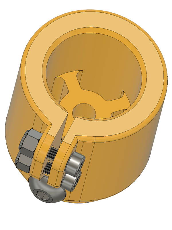

    I uploaded 2 updated spindle files, BambooPenSpindle_V2.stl & Dowel_31_75mmDia_Spindle_V1_1.stl that use the captive M3 Locknuts & M3x12mm screws to tighten against the motor shaft. I find this connection type a lot easier to swap different spindles out. I also included a STEP & fusion 360 file of the Dowel_31_75DiaSpindle. The fusion 360 file has some variables, but you will probably have to adjust the design some as well. I increased the Bamboo pen spindle hole opening from 11.1mm diameter to 11.4mm diameter which makes it a comfortable fit for me. I used a round file to slightly file the inside of the motor mount spindle until it would just slide on the motor without much force.
    Since the motor mount part of the spindle increased a little, I increased the motor mount opening more than enough to accommodate it. It would still fit on the other one, but you would not be able to push it as close to the motor. I also cut out more plastic in the design & still feels sturdy enough to me. The file is MotMnt_25mmHt_Top2040_V2.stl

    I added a couple more spindles to the file tab. One for 3/8" dowels (Dowel_9_8mmDia_Spindle_V2.stl) which I have a plethora of from a previous project years ago that did not go anywhere. I thought this size, 9.8mm diameter is a close size to the bamboo pens for test burns before trying the pens. The pens are 1mm larger diameter. I also added a toothpick spindle (ToothPick2_3mmDia_Spindle_V2.stl). Rather than use a tightening bracket for the toothpick which probably wouldn't work anyway, the toothpick spindle hole is tapered from 3mm. A drill chuck would probably work better and should get that & the new controller board in the mail in the next few days.

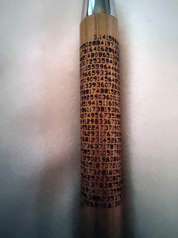

    How about Pi to 100 decimal places wrapped around a Bamboo pen? I will post the Lightburn file to the files tab.

    Make sure your machine limits for the rotary axis are long enough. That burn is about 290mm long in the rotary axis. I find it interesting that you can set that rotary axis to probably just about any length. I did 4 of these engravings before I was happy with it. The 1st two I did with single line text. On the 1st double line text, part of the number was under the pen clip. I changed the angle of the text to fix it. I was thinking about making another one with a lot more digits & smaller text, maybe 1000 digits. I would write a lisp program this time to generate all the numbers to get a closer distance. I manually moved all the digits last time which was a bit of pain, but looked good.

    Looks like making pi go to 1000 digits was easier than I thought. Lightburn shows it taking 10:39 which is usually all a few minutes on all the short segments. Rotary width is 947mm with 1mm high letters. I won't be able to test it until Monday. I might have to try pi around a toothpick next. Won't be too many digits though.

    Pi to 1000 places wrapped around a pen. The numbers are 1mm high & a little over 0.5mm spacing on the spiral.
