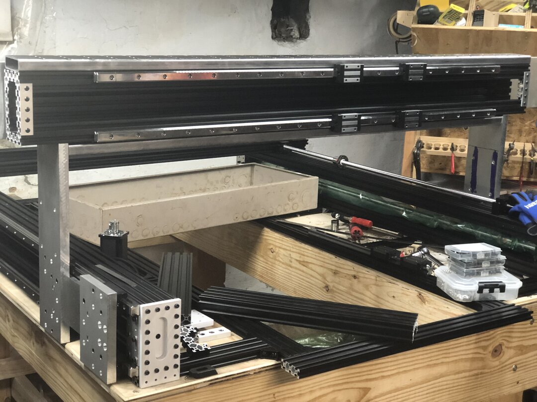

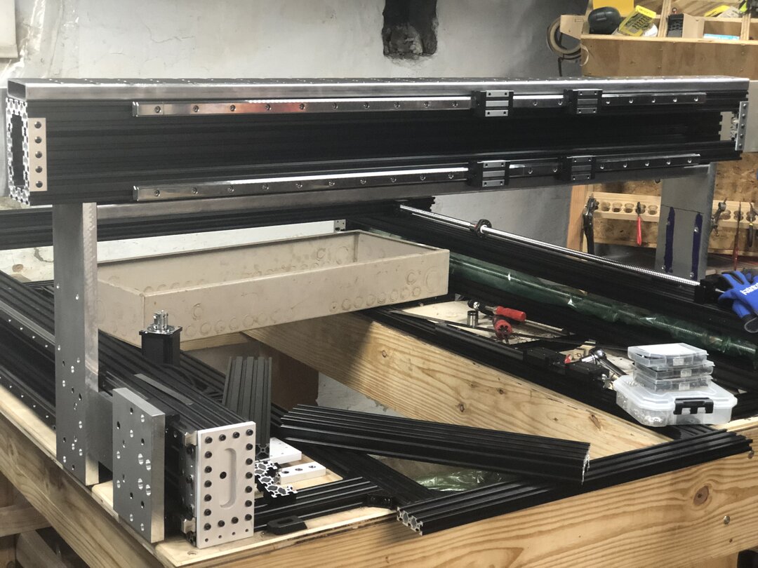

    Hi All,
    I will start this by stating that I do not know much about CNC routers. I've been watching a bunch of youtube videos and reading threads here and other sites and have decided to build a CNC roughly 1mx1m.
    Without a lot of planning I dove in and purchased 1m C channel from openbuilds and some linear rail from ebay as well as some 8x11" 1/2" thick aluminum plates an various connectors and screws. These items have come in and I've done a little assembly and mocked up a design and would like for folks who know a lot more about these machines to poke holes in my design so I can improve it. This will be a one-off build for me and I fully expect to tinker with it for quite some time.
    My goals:
    1. 1m x 1m - I'm assuming it will equate to @32"x32" cut area
    2. use a standard off the shelf router for a spindle
    3. repurpose an old laptop and load linux CNC on it
    4. nema 23 motors
    5. Use as many off the shelf parts and products as possible
    6. Don't customize expensive parts so as I learn more about this area I could re-use as many components as possible if I wanted to take the design in a different direction.
    here's what I've got so far
    1. purchased (3) 1m sections of C channel and have installed linear rail on both sides (I don't want to cut these pieces)
    2. (3) 1m pieces of 8020 for cross pieces
    3. I figured out the bolt hole pattern for the tops of the MGH15CA bearings and made small piece of 1/4" acrylic
    4. I've arranged this in a mock up of the design of the side gantry
    https://photos.app.goo.gl/6Yg7HeuPXJZRvJoW9
    https://photos.app.goo.gl/MkhpP1ubw7sMf39H8
    The concept being the C channel becomes a U and the rails facing upwards, a piece of 1/2" thick aluminum will go on top of the bearings and extend outwards @2" to provide a place to attach the anti backlash piece. The ball screws will be installed outwards on the small side of the C channel and the anti-backlash piece will be screwed to the underside of the plate.
    I realize that I will probably run into some issues with screwing the gantry pieces together and making sure they are 90 degrees as the joint will need some type of reinforcement where I currently have the spray can temporarily holding up the gantry.
    Going down this path, do you think I could use the nema 23 motor mount plates from this site?
    Any glaring problems you see?
    Thoughts on how I could improve it?
    Thanks in Advance,
    Matt

    Overall looks fine, a pretty good, inexpensive entry point to machine building. Assume that it's going to be a learning process and you're going to damage and scrap parts or decide to go in a direction that makes them obsolete. People (including me) can be reticent about info-dumping because the research process is a critical part of the learning process and can't be short-circuited, so it's usually best to offer ideas that can be pursued without going too overboard. One thing leads to the next which leads to the next, and had you been handed a fish, you'd be missing a good-size chunk of information that would otherwise naturally present itself.
    Can be any cut size area you like. Wider the carriage footprint, the more stability/rigidity- at the expense of machining volume.
    CNC and laptops don't usually play nice. Especially when the control is realtime like LinuxCNC. If others have done it, you could try and follow their lead, but I'd strongly recommend a cheap desktop and a Mesa 6i25. It makes the LinuxCNC process MUCH easier. If you don't need the performance level of LinuxCNC but still want a modern control, there are a number of 32-bit grbl platforms to look at. It seems to be a race between grblHAL and Grbl_ESP32, mostly.
    No, they're designed for very small lead screw and you'd have interference with a large ball nut, assuming 1605 screws. All plates will likely have to be custom. Some plates could be temporary, so the machine can make its own plates later.

    You can eliminate the two base mounting plates by rotating your lower c beams 90 degrees facing outward. After doing this, ditch the second rail (per side) and use both blocks on a single rail per side. You can attach the plates directly to the bearing blocks. This will decrease the fabrication work, fine alignment, and material usage. You will gain extra rigidity due to using distanced blocks instead of a single block at the gantry's load pivot point.

    Do this and get the blocks as far apart as you can. This will add a lot of rigidity to the gantry.

    This afternoon I cut one of my chunks of aluminum in 1/2 to make base panels
    https://photos.app.goo.gl/Uf77o5ACCqEwoS2D7
    then I tried making a piece of mdf with the bolt pattern for 2 bearings per rail. I printed off the bottom 1/2 of this drawing and taped it on a piece of 1/4" mdf and used a center punch to mark the centers and then drilled out the holes. I put the bearings on the rail and then screwed them down, I quickly realized that my drawing, marking and drilling was not accurate enough and then went back and drilled out the holes one size larger. The larger screw hole worked and all the holes lined up
    https://photos.app.goo.gl/HReToVa6AvbvHfAG7
    Once on the rails slid ok, I could push it and it would go 7-8" and stop, It required a small amount of force to start it moving and moved fairly easily but it is not as smooth as others that I've seen videos of. To try to make it better, I loosened the bolts holding down the rails and put the gantry right near a set of bolts and tightened them down moving the gantry along the way. This made the travel go easier but still not as good, I'm guessing I'll be learning a lot about this process :)
    It did seem to slide better when I put weight on the bearings.
    As for the comments about making the gantry as wide as possible, I have 8" wide aluminum stock for the gantry and was placing the bearings at the outside edges. When I ordered the linear bearings, I got the kits with 2 bearings for each rail so I have enough rails and bearings to do 4 per gantry surface.
    I understand the point about putting the bearings directly on the side of the gantry to cut out the # of pieces and K.I.S.S. but I would like to understand how to get a larger ball screw inside of the C area. Most of the ball screw kits I've seen have components which don't fit inside the C.

    It sounds like you're designing around an impossibility as a 16mm ballscrew will never fit inside the rails. 12mm fits, but you don't want to use 12mm due to whipping concerns. If you are willing to custom make a lead nut, you should be able to fit up to a 3/4" (19.05mm) or a 16mm lead screw.
    The resistance you're feeling has a large amount to do with the fact that you are pushing on four rails instead of two. You have the obvious extra resistance due to more blocks, but also extra resistance due to micro level inconsistencies in the rail construction and alignment. I don't want to assume, but considering that authentic HiWin rails cost an arm and a leg, I'm guessing you went with the China special (like the rest of us). Due to different manufacturing tolerances, the rep rails are inherently going to have a higher resistance.
    Two other things I can point out would be cleanliness. Having the channels cupped upward would lead to dust build up. This would hurt any lead screw that you can fit. You can also fabricate all of your parts in MDF to make sure everything fits and operates as expected before finalizing in aluminum.

    My project has taken a slightly different path, a couple weeks back I was browsing my local craigslist and came across an ad for a 6040 in my town for short $. I went and purchased it with the thoughts of designing and making the parts for my CNC on the 6040 and when I get my CNC up and running I would sell the 6040.
    The previous owner did the same thing, he built a better CNC with the machine.
    I've spent some time getting a PC built up with Linux CNC and interfacing with the 6040 via the parallel port. I was able to get it up and running and it seems to work fairly well. I've done some carvings of my kids names in wood as well as converted a few images to basic carvings. I am reasonably happy with the setup.
    I've also gone down the path to purchase components to build a control box for my CNC with the thought of doing the same wiring setup as the 6040, get it all to work, then transfer it to my cnc when it is finally ready. I've purchased a 7i96 mesa card, stepper motor drivers and a pair of 7.3amp 48v Power supplies.
    Back to my original project, One of the questions I have is the design of the screw holes and using fusion 360, it seems no matter what tool I choose I cant get a tool path for a m4 sized hole. How do folks go about doing this? Is this something you build a recess for the head of the bolt and that tool path is fine, then use a centerpunch with the right diameter to mark the center of the hole and drill that out the correct diameter?

    Thank you for the info, I'm guessing that I would run one program to do all the Bore functions then bolt the panel down to the machine base, through the bolt holes then come back with a larger endmill to cut out the panel
    As you can see from the photo the previous owner made his gantry plates on the machine. BTW the guy had an amazing machine shop in his basement and his new CNC was sweet.
    https://photos.app.goo.gl/aFyv1ByK8W3XSADR9
