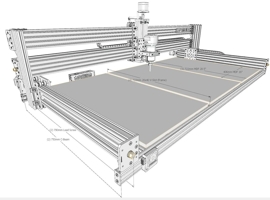

    Is this considered a shorter version of a 1515? if later on you want to turn it into a 4x4 is that a possibility? what modle number is this?
  2. Rick 2.0
    2,910
    1,568
    Yes, the frame members should have been 722mm or just shy of 28-7/16"
    jtadams likes this.
  3. Rick 2.0
    2,910
    1,568
    Yes, and with a couple of simple adjustments it will do 22.5" x 48" which means it'll almost do an 8 foot sheet, 2 feet at a time.
    Yes
    Was a custom request. If you wish to make a similar request contact the shop as noted above.

    I am new to CNC routers, I currently have a BOSS Laser and want to venture out to a CNC router. looking at Openbuild 1515 loaded.
    I notice there is no phone number to call anyone at Openbuild, or showroom to go look at the equipment, they have been answering my questions via email. I am trying to find out what loaded means if this includes the hand held interface controller and everything else I need to build it and start running projects with the exception of the spoiler board.
    I am looking at the 4X4, however knowing there is also a 2X4 I am wondering what the price difference is and if it would be worth starting with a 2X4 and later expanding to a 4X4, not sure what it would take to expand.
    I am also having some concerns trying to find out is the 1515 4X2 or 4X4 handles a full 48" width sheet (the standard with of plywood material).
    Thank you for any advice or suggestions.

  8. Rick 2.0
    2,910
    1,568
    OpenBuilds is a small business and 24/7 phone support and fancy showrooms are just not viable. Product support/questions is handled through email with the OpenBuilds parts store and technical questions/how-to's are handled through the forum. This may seem awkward but the system actually works very well.
    Everything included is shown in the description. Which is essentially everything but bits and the spoiler board.
    There isn't really a 2x4 model, this was a one-off created as a customer request. As the systems is fully modular the cost of a later expansion is fairly simple to determine. You'll need (2) 1500mm C-Beam 40x80 Linear Rail Aluminum Extrusion Profile (openbuildspartstore.com), (2) 1540mm 8mm Metric Acme Lead Screw - OpenBuilds Part Store, and (4) 1500mm V-Slot 20x40 Linear Rail Aluminum Extrusion Profile (openbuildspartstore.com) cut to 1472mm.
    It will fit the 48" width no problem but as the description of the stock configuration shows, it'll only cut 46" wide. This limitation is easily overcome though by raising the vertical X-gantry members 23mm which allows the X-gantry to pass above the Y-axis carriages. This allows for the full 48" cutting width desired. (You may also want to slide the Z-axis framing down 23mm to compensate for raising the gantry.)

  12. jtadams
    jtadams New
    Jun 15, 2022
    35
    19
    Thanks Rick!! Just got done cutting everything down and went back together perfectly IMG_1209.jpeg IMG_1209.jpeg IMG_1210.jpeg IMG_1208.jpeg

    Hey guys! Installing the drag chains and assuming the Y-axis needs to be trimmed down a bit to fit the custom size?
  14. Rick 2.0
    2,910
    1,568
    Yes.
