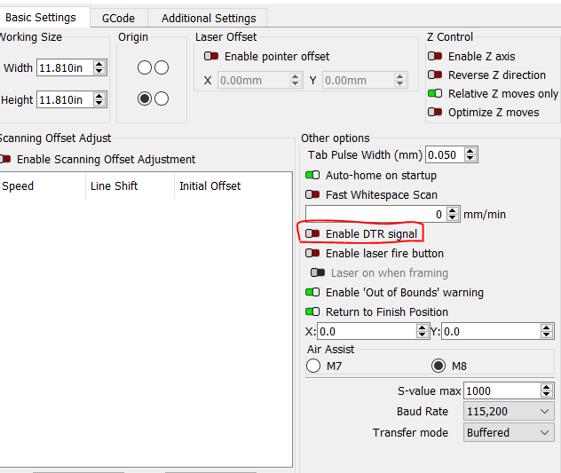

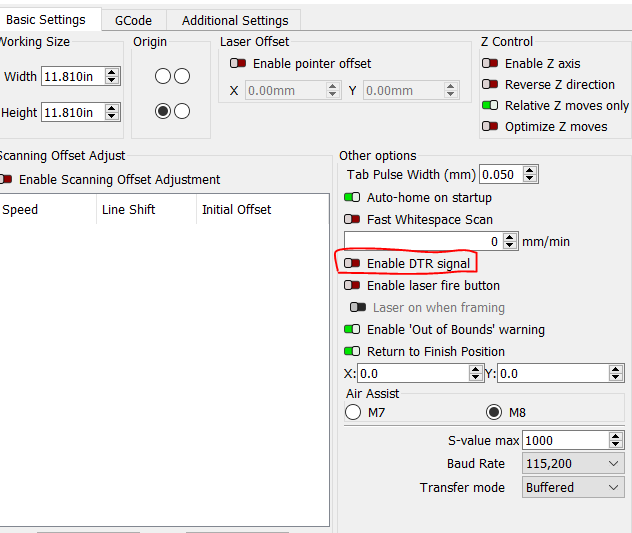

    Play with the Enable DTR setting: Try it with and without
  7. Odin187x
    Odin187x New
    Nov 29, 2021
    Apologies, I missed this. DTR is off, I will try it now while one.
    One thing I have noticed, is when I go to devices and connect to the machine, the motors initialize as if connected but, I cannot pull up my GRBL settings in LightBurn. It doesn’t show any settings or machine when I go to machine settings.
  8. Odin187x
    Odin187x New
    Nov 29, 2021
    Turning the DTR on has given me control over the machine. I have only jogged, at the time of writing this but, this is very promising. I appreciate your time, effort, and help on this matter!
