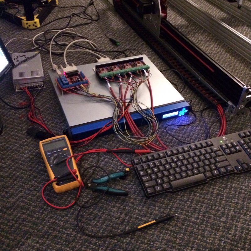

    Any recommendations for higher current drivers? The Poloku drivers can't handle the NEMA 23 motors according to their specs, they have a max of 2.2A, and the motors I got (as well as the parts store here) are 2.8A. For my PPR project, I am using the Planet CNC MK3/4, and bought a 4-axis TB6560 to interface it with. However, that board had a bad reputation for skipping steps. So, I may return it.
    I am considering TB6600 drivers, the 4-axis TB6600 board seems beefier, but there is less info out there on how well it performs. I have seen good and bad reviews on the HY drivers.
    Anyone driving those 2.8A motors with Pololu drivers? I am worried I won't get the speed I need if I did that, for the plasma. On the other hand, when running as a plasma CNC, I will have no force acting against the gantry.
    - Steve

    If you go with the TB6600 then go for the single axis drivers.
    The all in one boards are very poor designed and tend to fail more so then the single axis and I believe it is due to how they power the boards that cause the issues.
    Keep in mind also the higher the voltage the more hiss or wine you will notice from the motors.
    I find 24vdc to work best and have yet to burn one using that voltage.
    Always power off the system when making changes to the boards like dip switch settings or wiring the motors, leaving them powered up will burn it up fast and I have had one chip shatter.
    The wire connectors on the single axis china boards are also a pain, but do the job and for a $20 driver I'm more then pleased with their performance
    Controlled with a BOB "break out board" and Mach3
    Controlled by an Arduino nano GRBL

    Robert - I found the same 6600's you show there. I am leaning this direction. Do you have experience with one form of 6600 board over another. If the one you show works for you, that works for me. I do like how they'd get mounted.
