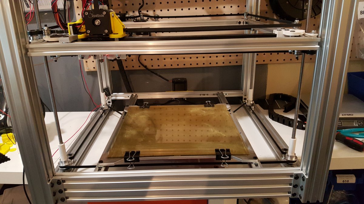

    What is that pause when the loop ends and starts back up?
  3. Adam Filipowicz
    Adam Filipowicz Journeyman
    Dec 21, 2014
    261
    137
    the Z adjusts to the next layer. at that point, it was not set to vase mode.

    I do notice that it still pauses, running at 150mm/sec the rumba has trouble keeping up
  7. DarkAlchemist
    DarkAlchemist Well-Known
    Aug 2, 2014
    401
    22
    Rumba is just a beefier Ramps and I know that on Delta printers they have to use an ARM based controller like a Smoothie board to keep up. Sounds like that is what is needed for this too.

    finally figured out the problem with my Rumba and Marlin, I had the Serial port set to 3, thinking it was the same thing as the com port setting on my pc, once i set it back to 0, it connected fine

    Here is a video of it actually printing for the first time.
    it ran into a heating issue.. as the fan was cooling the hotend too much and it couldnt hold its temp
    and went into a thermal shutdown. I like how the BLtouch sensor flashes when someone goes wrong

    Finally received a longer loop belt to drive all 4 Z screws. Upgraded to a single Nema 23 Stepper for the Z for the torque
    I will also be adding in Ustepper.com upgrades for the X,Y&Z to turn the steppers into Servos.
  26. Adam Filipowicz
    Dec 21, 2014
    261
    137
    Single Nema 23 running Quad Acme screws is working well!

  28. Adam Filipowicz
    Dec 21, 2014
    261
    137
    Currently running on a rumba. Im going to wait until I can get Marlin on a 32bit board before i upgrade.
