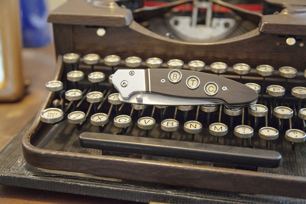

    I absolutely understand the desire for authenticity - feeling the need for the realness of the materials beyond just their apparent accuracy, for top-grade ebony inlays rather than substituting utterly indistinguishable black plastic just because knowing what's in there is even more important than how it looks... but when you have to cannibalize something you know will never be made again to get the components for something else? That's always a hard one.
    In the case of the knife, his hobby is repairing old typewriters, so he appreciated the fact that I'd avoided destroying any to make the inlay... but when you've got a client who wants the real thing?
    I guess there's no alternative but to own all the tools, and manufacture replicas from the molecular level up!
