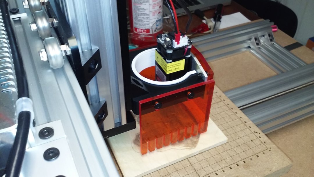

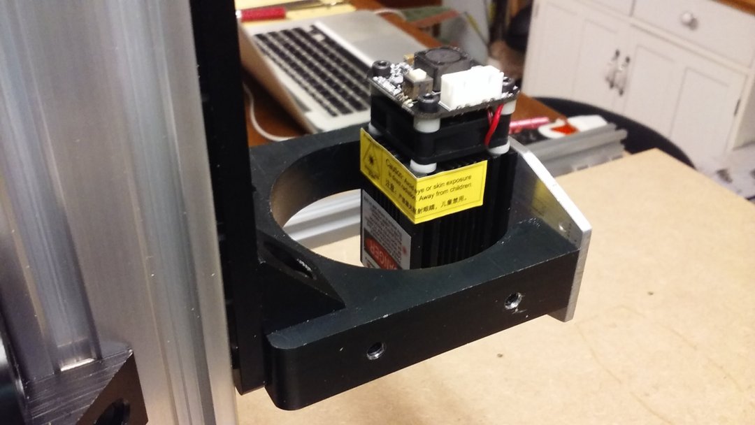

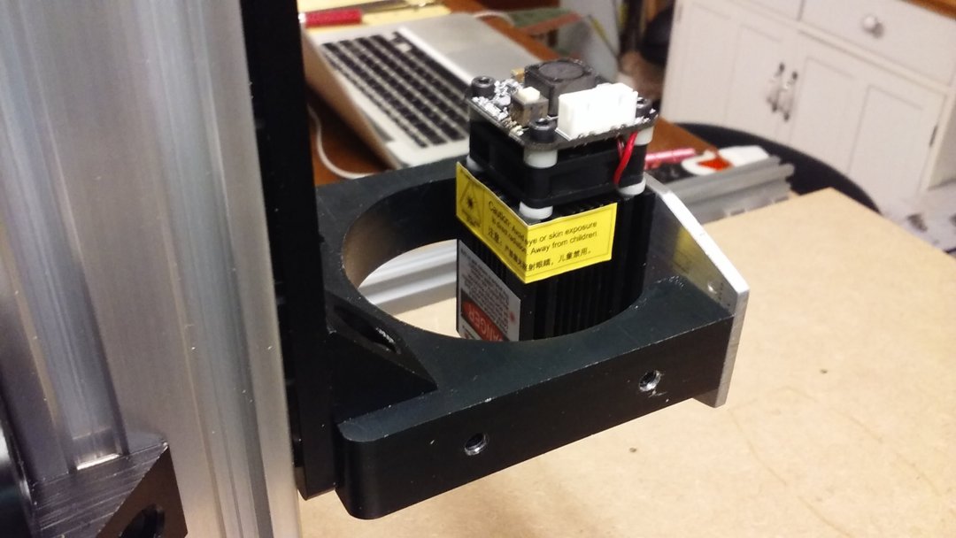

  4. Scotty Orr
    Scotty Orr Journeyman
    May 21, 2015
    315
    178
  5. Giarc
    3,045
    1,705
    I am building a box as well. Unfortunately, mine will be much longer since the focal length of my laser is about 180 mm.
  6. JustinTime
    JustinTime Veteran
    Dec 18, 2013
    784
    259
    Scotty, is that a cream-cheese/sour-cream tub that is encasing your diode?
  7. Scotty Orr
    May 21, 2015
    315
    178
    No, that's my 3D printed router adapter for my Makita - I just leave it in place when swapping out the router for the laser mount.
